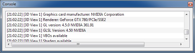

With updating to 2.7 we removed any previous versions. Opening CC 2.7 being logged directly onto the computer we have the following OpenGL and graphic card manufacturer:

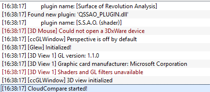

We found an old installation file for 2.6.2 that we were able to reinstall on our computer. When opening via remote desktop the console shows:
Re: Error opening 2.7 over remote desktop
Ok, CloudCompare 2.7 requires OpenGL version 2.1 at least.
I wonder if remote desktop can 'emulate' OpenGL 2.1 instead of 1.1?
Meanwhile I'll try to prevent CC from crashing when running with lower version (and issue a proper error message instead ;).

Hardware acceleration doesn't work with Microsoft's Remote Desktop client and the Geforce drivers. It looks like software opengl isn't implemented as a fallback any more in CC so it crashes.
The Quadro driver's do support hardware acceleration over remote desktop. Various third party remote desktop clients also support it with Geforce cards. If you start the opengl application from a local session then connect to it via remote desktop hardware acceleration will also work.
