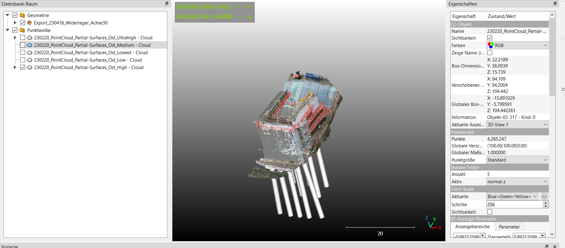

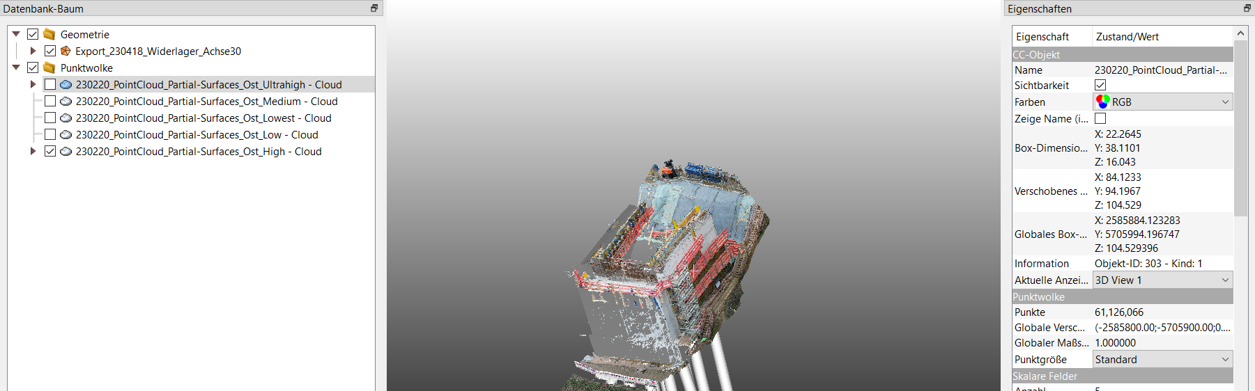

I finally came to do my project in the 2.12.4 version.
I have registered the Point Cloud with Ultra-high Quality, with seems to have then the global coordinates of the mesh model:
Then, I applied the transformation matrix of the previous registration to the others point cloud, but then they don’t have the global coordinates:
Any ideas? Still want the CC file?
Re: export of aligned point cloud to mesh with geo coordinates
Posted: Wed May 17, 2023 9:00 pm
As discussed via email, your issues came from the fact that the registration matrix output in the Console was transforming from a local to another coordinate system (as both entities were shifted). I changed the latest 2.13.alpha version so that it also outputs the matrix from local to global CS.
