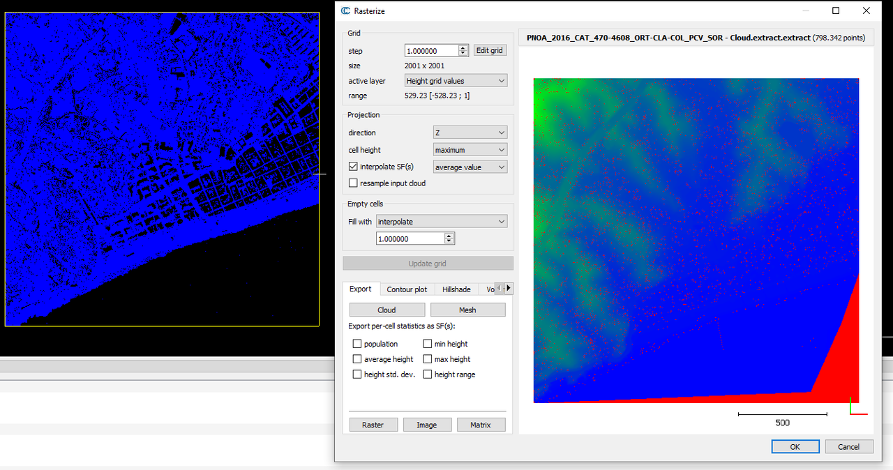

Rasterize tool, corner line bug
Re: Rasterize tool, corner line bug

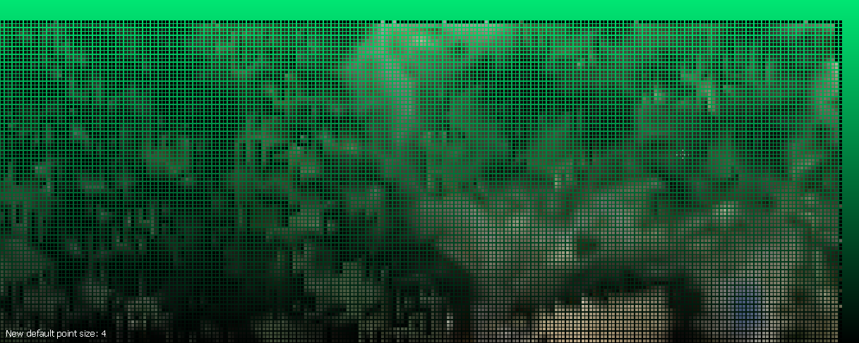

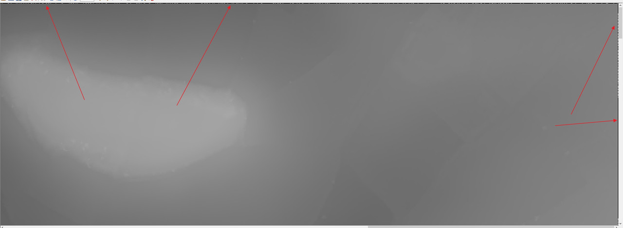

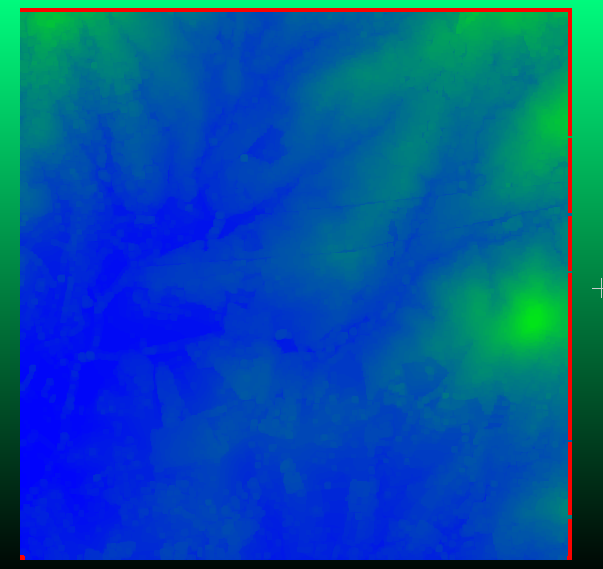

Hello, I checked by exporting to cloud
both RGB and Heights, the issue persists:
RGB (green background so balck dots are mor visible)
Heights, all the red corner, also noticed that singel red pixel in bottom left.
This is the cloud I used in this particular test to generate the screenshots:
https://mega.nz/file/sg8mRS7S#tXyxrVkNj ... dsxhHIOjXc

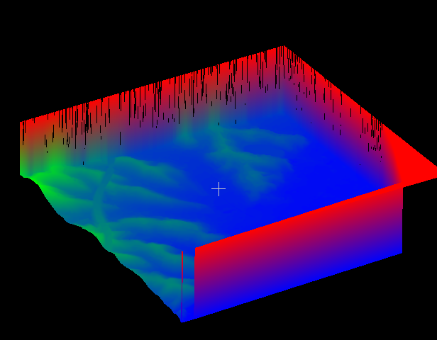

So I tested a bit further and I believe this issue is related to using "interpolate" I'll test more tomorrow and post with the definitive info
- Posts: 286
- Joined: Sat Jan 20, 2018 1:57 pm
So I took some time to test further,
After separating the ground of the already classified cloud.
I go to the raster tool, if I interpolate on the ritght and top corner last pixel row/colum won´t interpolate correctly.
I suspect that what happens is that interpolates taking the new upper and near right pixels of each pixels and fo the most corner pixels in top and right there is nothing to interpolate to and applies 0 value. Or something simialr. Also in some clouds, to bottom left, first pixels ocasionally fails in a similar fashion.
Furthermore, I was doing a video to ilustrate, and seems like on first attemp the tool does the job properly, to my surprise, for in the following attemps the tool fail as spected.
HEre the video:
https://youtu.be/LXubL5BP_T8
The point cloud in the video
https://mega.nz/file/coNhAKxD#XorHShG4G ... BMmzjKf_t8
Thanks for the extensive tests and data.
I reproduced the issue. And I don't clearly understand why it happens, but I guess it's some limit cases, where numbers fall on the wrong side of the boundary. I added additional tests to save these limit cases, and I believe it should solve this issue.
I've updated the 2.12.alpha version online (for Windows). I'll let you test.

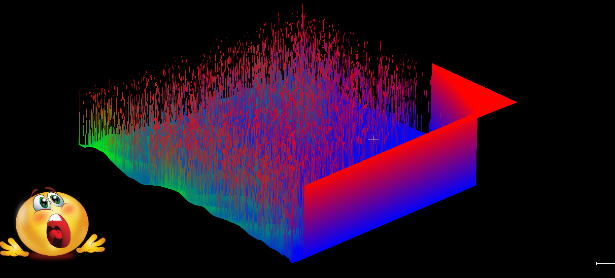

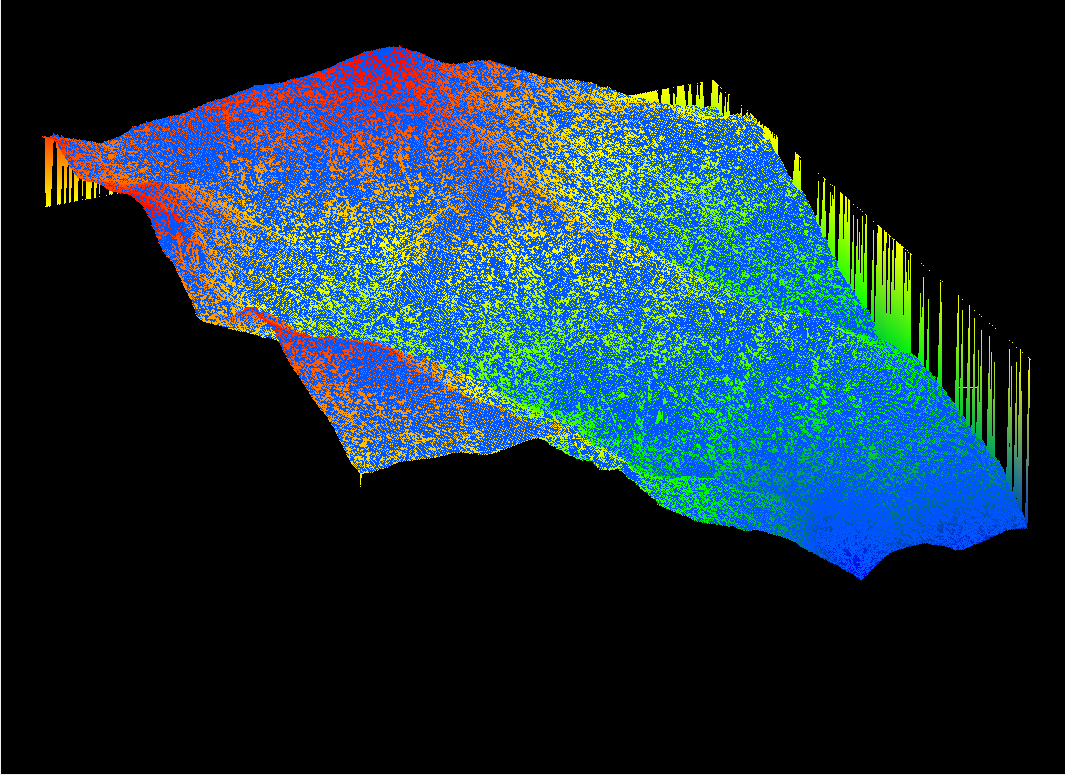

Thank you very much for the new beta,
sadly I belive issues have become worse, while now on corners seems to not add the issue, now the issue is all over the raster XD
Plus non interpolated values seem also affected:
this is the exact blue cloud shown in the images in case you whant to test:
https://mega.nz/file/1pVg3D5I#uwSEwD6ZX ... EpNAluwzAo
Ah yes, good catch. I added a safety test while changing the code, but it seems that this test made things worse... I commented it and updated the latest 2.12.alpha version.
Thanks for the test!
