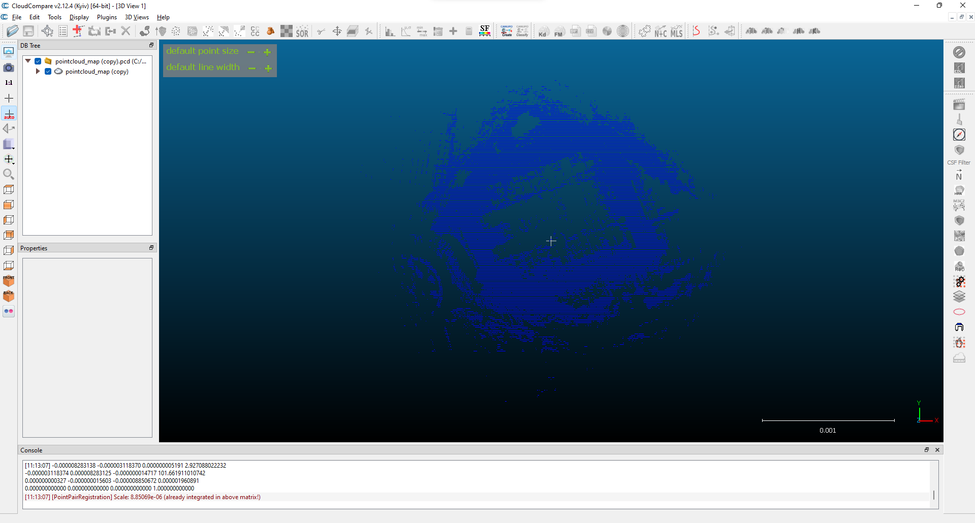

I'm really new here in CloudCompare, georeference, and other general stuff. So please apologise if my question is simple.
I just learned how to align one cloud with the real coordinates. When I finish pointing the coordinates, I click align and press Enter, it becomes like this.
If you notice, the scale on the right bottom becomes smaller.
It becomes a problem for me when I upload it to Tier4 Vector Map Builder. The PCD does not load anything.
Question is, how can I do georeference properly without the PCD data becoming smaller (compared to using a scale)?
Thank you, guys. Let me know if you need more information on this.

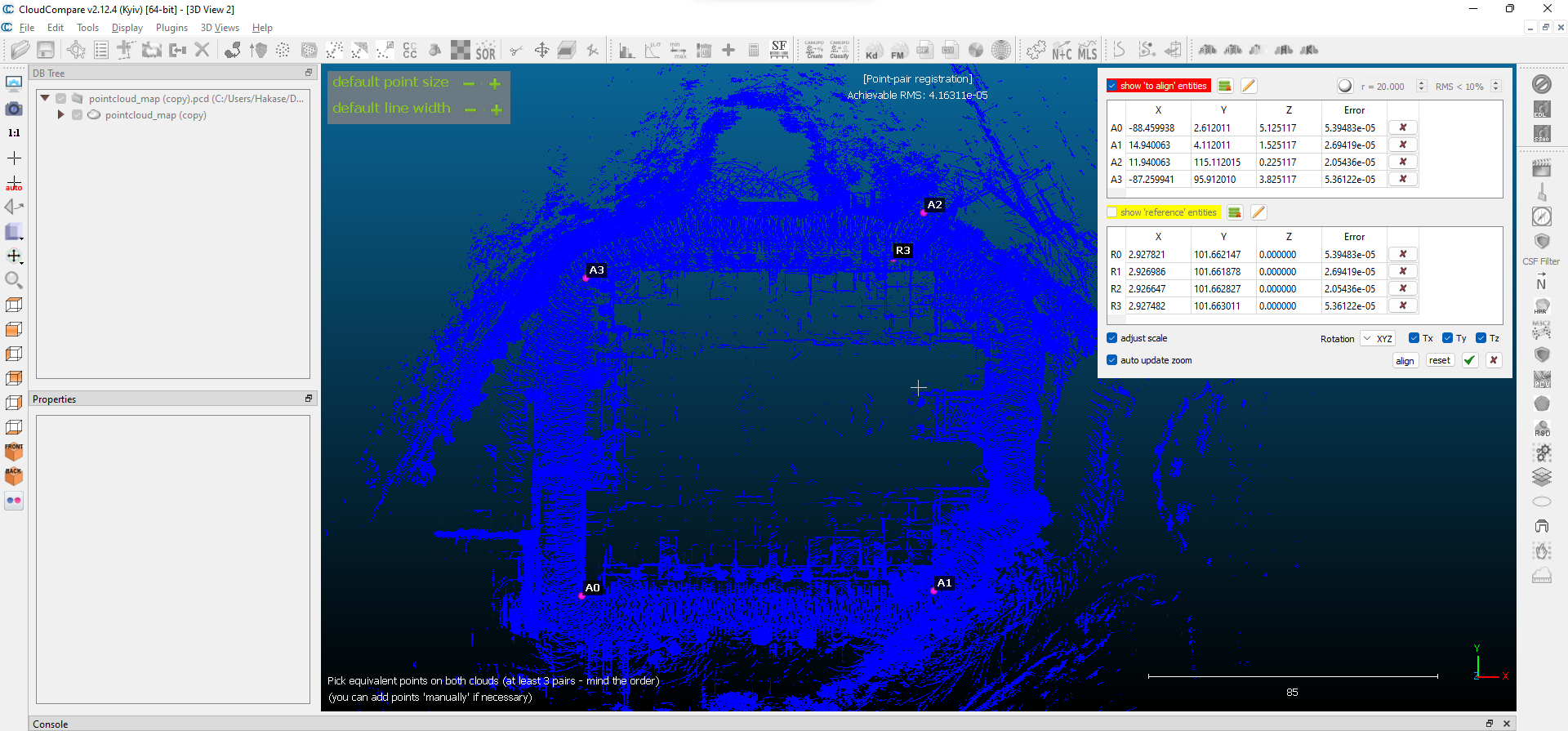

I'm not sure if it's large or not. The local coordinates in PCD are as follows:
-88.459938, 2.612011, 5.125117
14.940063, 4.112011, 1.525117
11.940063, 115.112015, 0.225117
-87.259941, 95.912010, 3.825117

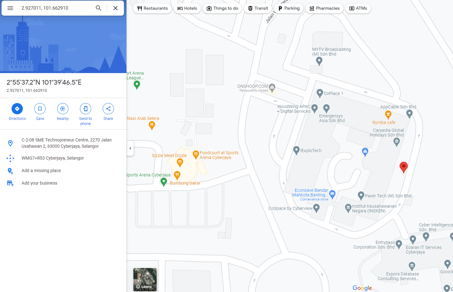

And global coordinates that I align the point pairs are:
2.92782083, 101.66214713
2.92698574, 101.66187756
2.92664684, 101.66282667
2.92748175, 101.66301075
For the Global Shift, when I load the PCD, it didn't ask to apply Global Shift. Do I need to convert .pcd to .las first? Or I can just directly adjust Global Shift?

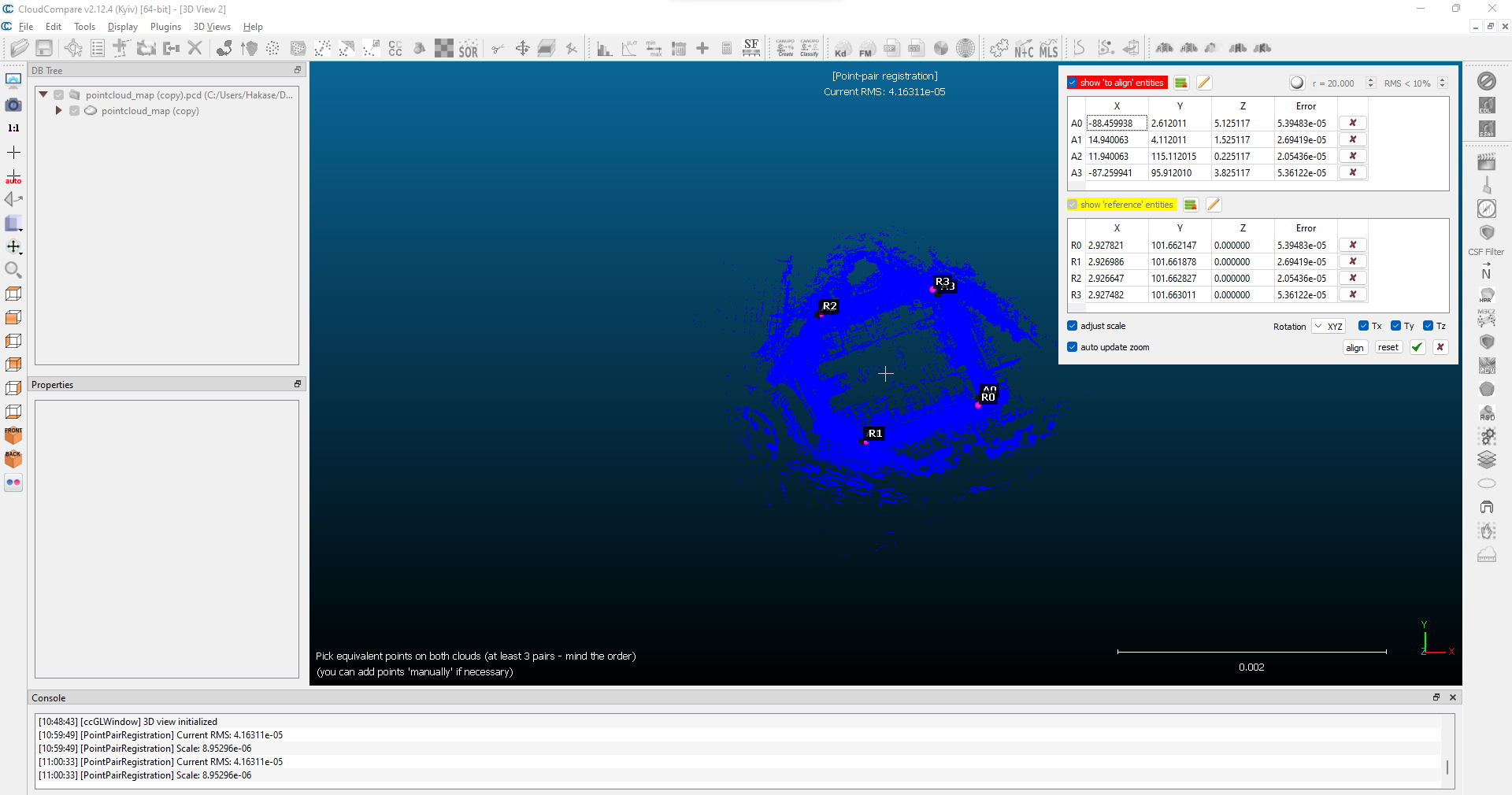

Below I attached my screenshot of aligning the pair points.
If you notice, the scale now is 85. This happened when I click align. It rotates the PCD and the scale becomes smaller. The scale is now 0.002
Re: PCD data scale become smaller
Posted: Tue Nov 08, 2022 10:54 pm
Ah, I understand now. Since all the Z coordinates of your reference points are 0 (= 2D points), and you tell CC to scale the align cloud (3D) to best fit the points, it ends up rescaling the aligned points with a ridiculously small scale (so that 'P.z * 0 = 0' basically).
You can't align 3D points with 2D points this way... You would have to make a clone of your cloud first, then flatten this clone (with 'Edit > Multiply / Scale' and use 0 for the Z coordinate only). Then align the flat clone with your 2D reference points. Look at the resulting matrix in the Console (F8) and copy it (CTRL+C). And eventually, you can apply the same matrix to the original point cloud with 'Edit > Apply Transformation' (and paste the matrix there, either with the 'clipboard' button or with the CTRL+V shortcut).

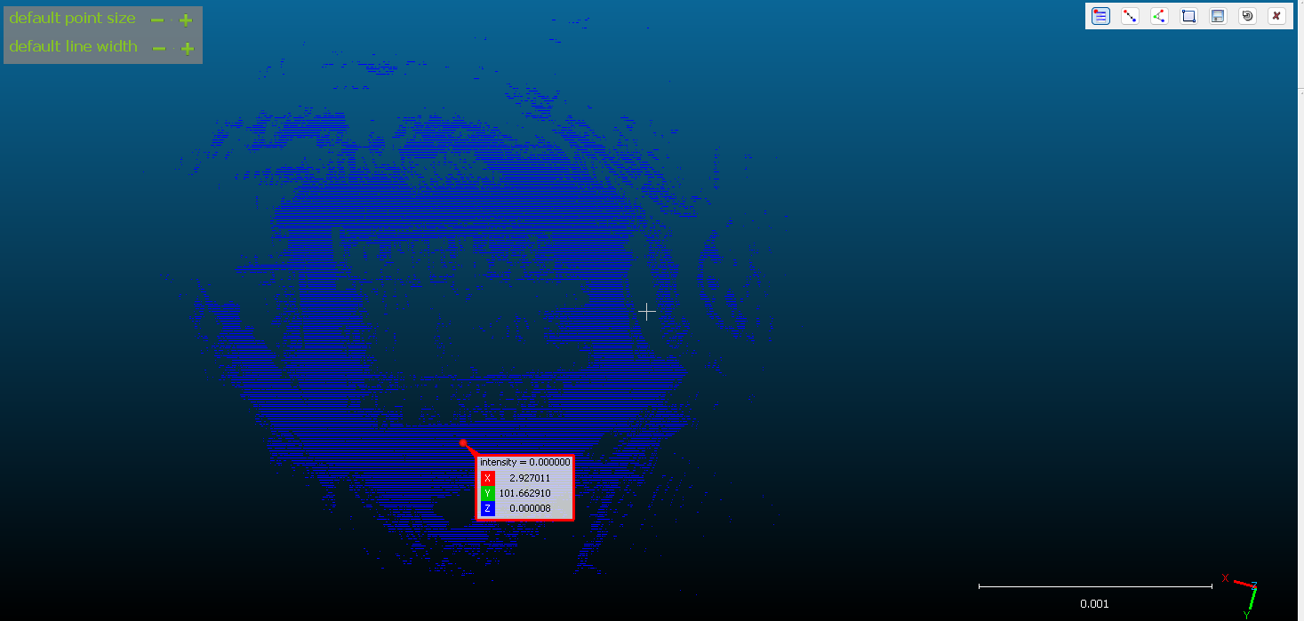

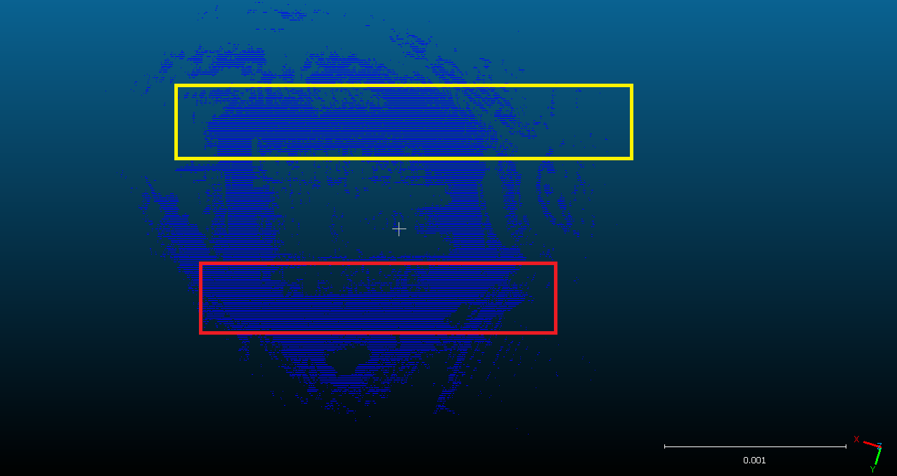

EDIT:
I just found out. The global coordinate after alignment and scale is a bit weird.
The picture above is after alignment. What I can see is the coordinates in the yellow box should be in the red box, and vice versa. But it's fine on the left and right sides. Do you know why this happened?
Below is example:
Thank you!
Posted: Wed Nov 09, 2022 7:50 am
Oh, I think it doesn't really makes sense to use 2D angular coordinates to match 3D cartesian coordinates... The 'align' tool performs rigid registration, and I'm not sure that converting from cartesian to angular coordinates is particularly 'rigid'.
The other issue, once again, that the resolution of the 4 pairs of GPS coordinates you picked in Google Maps is actually very coarse (something bigger than 10 cm in average I believe). You would need more digits to get a reliable result (an angula resolution that would be equivalent to mm accuracy I guess).
At least for now, if you want to make things a little bit better (visually) and have a better feel of what's going on, you could truncate the coordinates when doing the registration so as to limit the numerical incaccuracy:
2.92782083, 101.66214713 --> (- 2.9) * 100 = 2.782083 / (-101.6) * 100 = 6.6214713
2.92698574, 101.66187756 --> 2.698574, 6.187756
2.92664684, 101.66282667 --> 2.664684, 6.282667
2.92748175, 101.66301075 --> 2.748175, 6.301075
Then you can manually scale and recenter the resulting cloud (with 'Edit > Multiply / scale' for divide by 100, and then with 'Edit > Apply transformation' to translate the cloud of X = +2.9 and Y = +101.6.
I would be interested to see what's the result in this case. But I believe the result will still be off due to the metric/angular projection, and the limited angular resolution of Google Maps GPS coordinates.

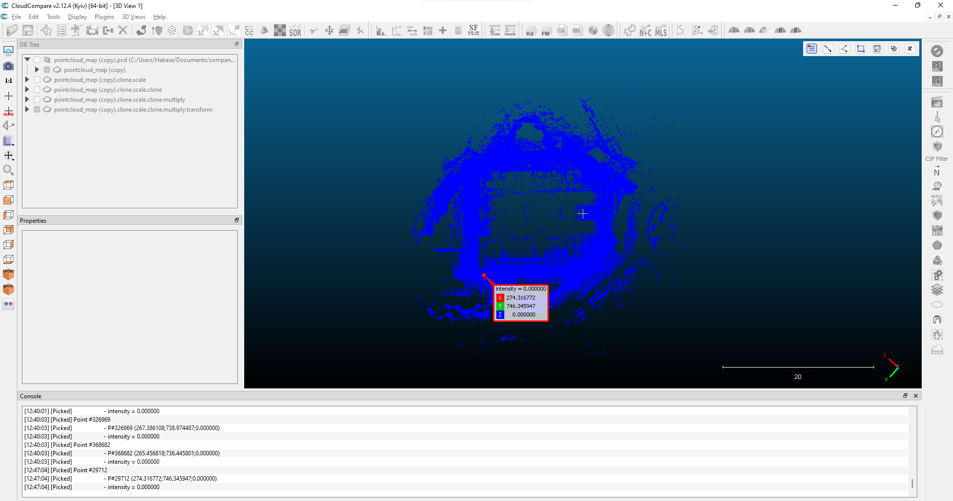

Hi Daniel.
I did as you suggested. But it still did not produce the correct georeference.
What I did is flatten the pcd (z: 0), register coordinates local, and truncated global coordinates. scale up pcd to 100 times for all dimensions, and apply transformation (translate: x; 2.6, y; 101.6).
Did I miss anything step here?
Below is the result.
Here is the video from when I do the georeference.
https://youtu.be/FKtys-czzm8

Well, my point was only to improve the numerical accuracy and fix this 'strips' issue.
But I still think you can't register a cartesian 3D point cloud with angular coordinates with a rigid registration algorithm such as the ones implemented in CC.
