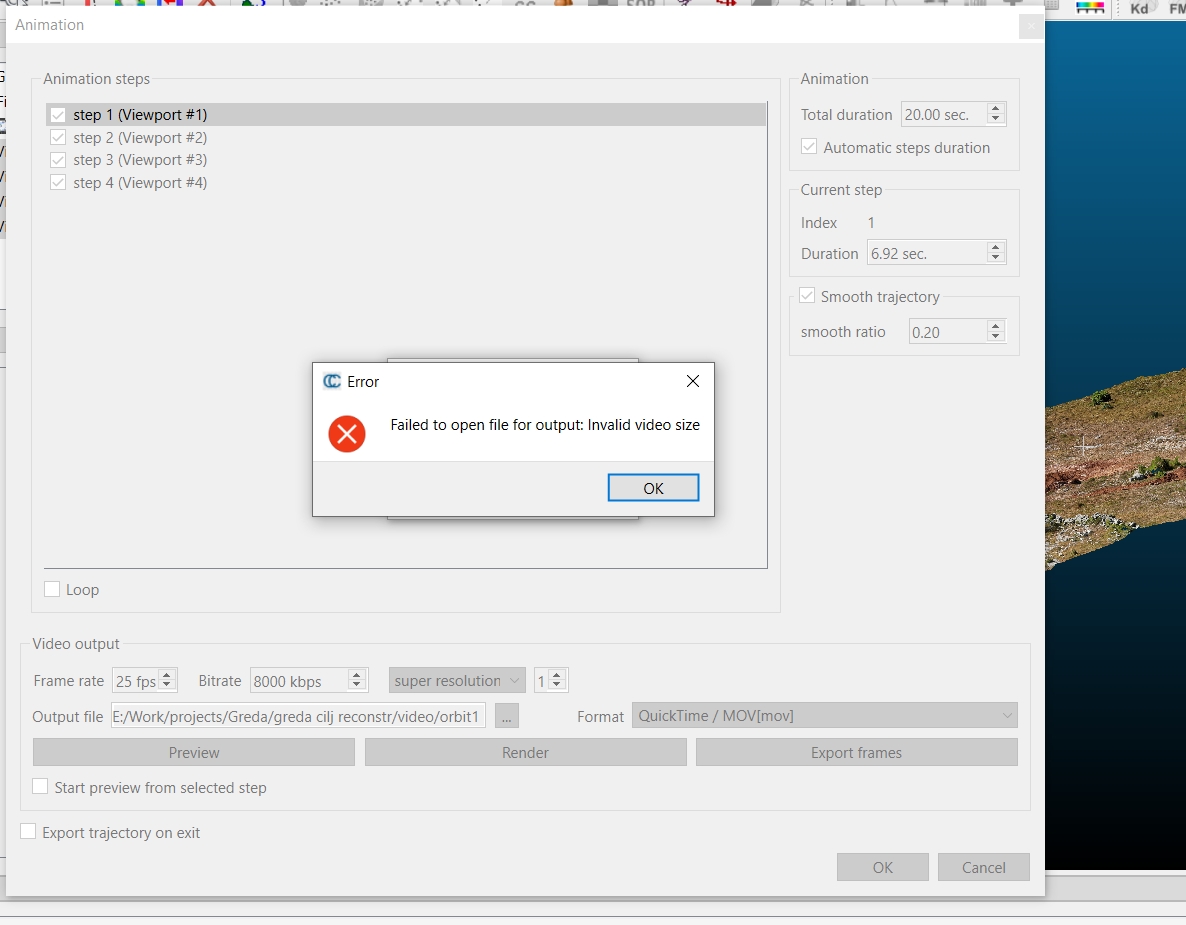

hi, I would also like to bump this, we get same message.
video cloud compare.jpg (209.53 KiB) Viewed 6335 times
Preview is working ok, Export frames is working also, but when you click Render, that message apperas
we tried with MOV and other video formats, same message.
frames can be exported and processed in third party software, but it would be much easier if Render work
Posts: 8207
Re: FAILED TO OPEN FILE FOR OUTPUT: INVALID VIDEO SIZE
Does it work better if you try with a output path that has no space/blank character?
