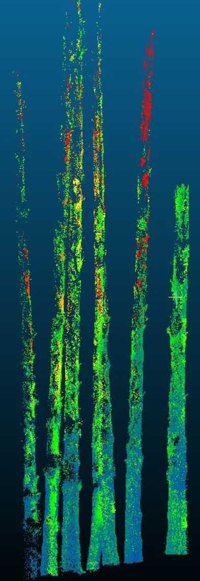

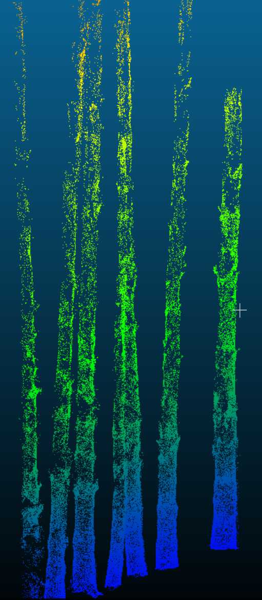

I am sure you are aware that this is related to creating the DSM from the other question forum. I set a step of 0.0025 to maximize the resolution. When I change the scalar field property to "height range". Some of my points in various heights on each tree stem turn blue, indicating they are ground points. When I set the scalar field to Z coordinates, those blue points drop to the ground, leaving me a lesser resolute tree.

If you set a too small grid step, then there's a chance that only one point that falls inside a cell. Or even if there's several points, there's a good chance they will all be very close to each other (in altitude). In this case, the 'height difference' inside the cells will be very small.
