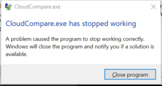

After running this a pop up console appears. A get a series of messages and loading bars for loading in the PointCloud, applying the transformation, sampling the mesh and loading the reference mesh (stl file). After this, the system crashes and I get a pop-up which says that CloudCompare has stopped working (I have attached an image of this). Finally If I run the above command without the -ICP, then everything works perfectly and it saves that scalar field. Furthermore, If I run this entire operation using the CloudCompare application (GUI) then it seems to work perfectly ICP and all. I need the ICP to create a more accurate Scalar Field.

Re: CloudCompare Crashes every time I use ICP from CommandLine
Which version are you using?
I experienced the same thing when registering two meshes with the 2.10.alpha version. I still haven't found why it crashes?!

I am using v.2.10.alpha [64-bit].
Is there a newer version where I can do the same thing? Or Do I need to downgrade to an older version?

For now you should use the stable 2.9 version.
