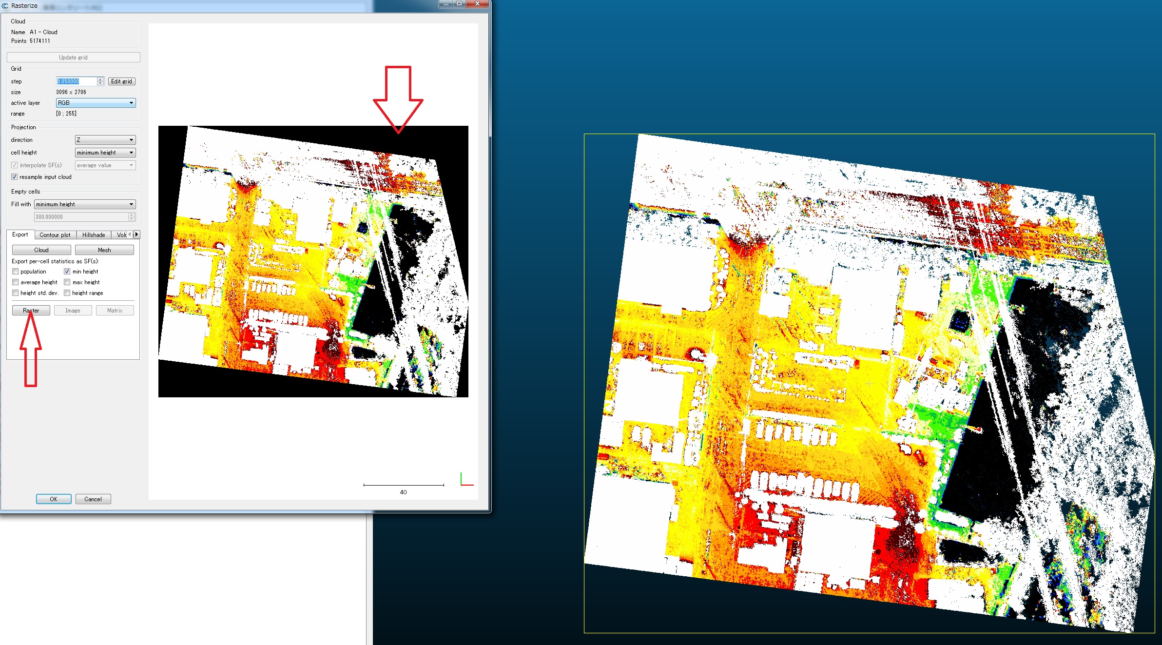

I want to make the margin of the raster transparent or white
kato@apeo.jp
Joined: Thu Feb 23, 2017 5:33 am
Post by kato@apeo.jp »
I want to make the black part transparent or white when outputting Geotiff
Thank you
Re: I want to make the margin of the raster transparent or white
I believe you have to use the 'empty' option for the 'Fill cells' field.
The drawback is that it might also make some potential holes in the central part of the raster transparent...
