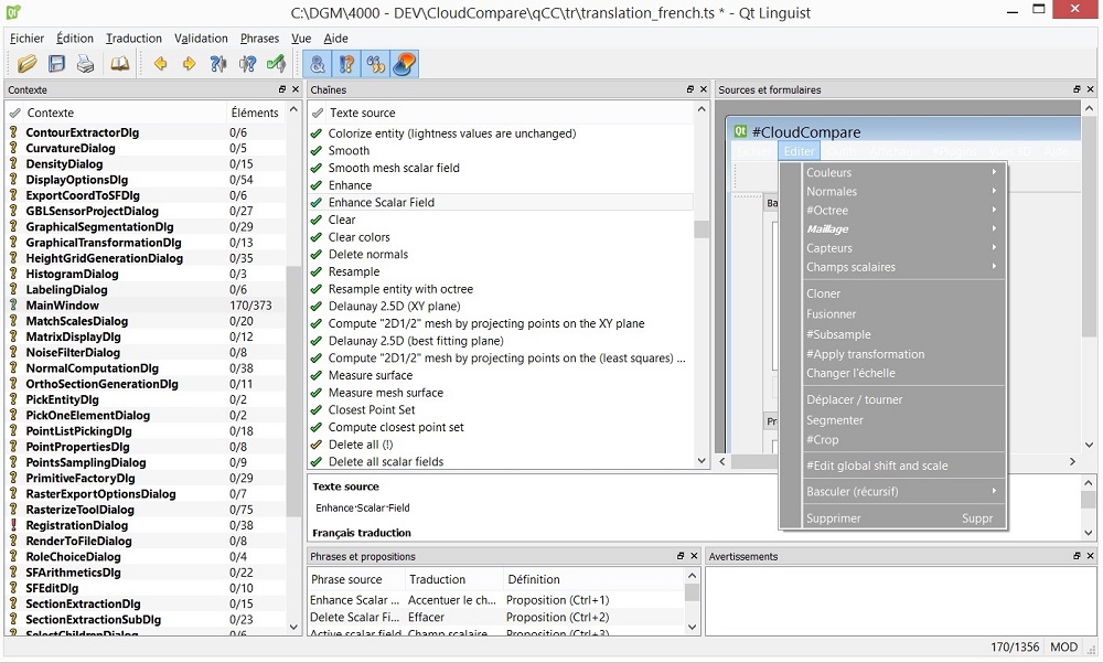

Translating
Translation is done with Qt Linguist (see the documentation here: http://doc.qt.io/qt-5/linguist-translators.html). Simply install the latest version of Qt to get it (you'll found linguist.exe in the 'bin' folder).
Then simply open the right '.ts' file in Qt Linguist and you can start the translation job!
Start by the 'MainWindow' component (this is the main GUI of CloudCompare). You can easily see how the work progresses (see below).
Releasing / testing
Once done or any time you want to test the result for real, you have to 'release' the translation file (use the 'File > Release' menu). This will generate a '.qm' file next to the original '.ts' file. This file can be copied into the '/tr' folder next to CloudCompare's executable.

Hi Daniel, I'll start the french translation (even if translating in the dev's native language adds a little bit of pressure ^^)
edit : fyi, the ts files may have to be hosted out of the main repository, we had to limit their updates in QGIS as the xml's diff were huge and slowing git cloning

Hello Daniel, I would like to start the Latinamerican Spanish translation, but I'm unable to find the "QT Linguist" tool on the bin folder. I have the open source version, maybe that's the problem?
As an alternative, I seem to be able to open the .ts file just fine in VS Code for example, do you know if directly editing that way is good enough?
Re: Translation / Localization
It's actually the bin folder of Qt (you can install any version of Qt to get it - but if you wonder, we currently use the 5.9)
Oiz
Posts: 16
Joined: Mon Jan 14, 2019 9:44 pm
Post by Oiz »
Aaah, yes, I've found the issue. I was just installing QT Creator plain and simple as default, without selecting any version in particular. I just selected the latest one with just a couple of compilers (which made the installation of QT to go from a couple hundred megabytes to 4GB...) and then it gave me all the tools including the Linguist. Kind of an odd decision on their part, but that's how it is.
Anyways, the spanish translation is ongoing. Let you know when we get any significant progress.
