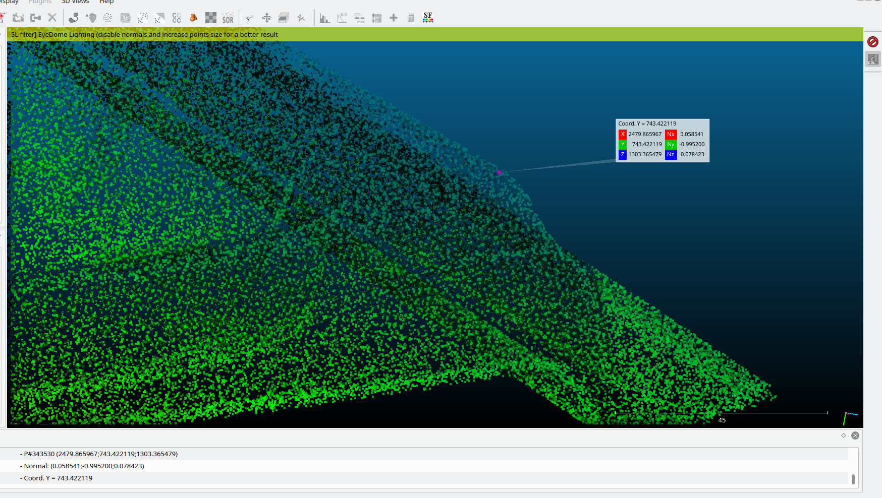

I want to use CCLib to display labels at certain points on my cloud. I want to achieve something similar to what happens when you use the Point picking tool.

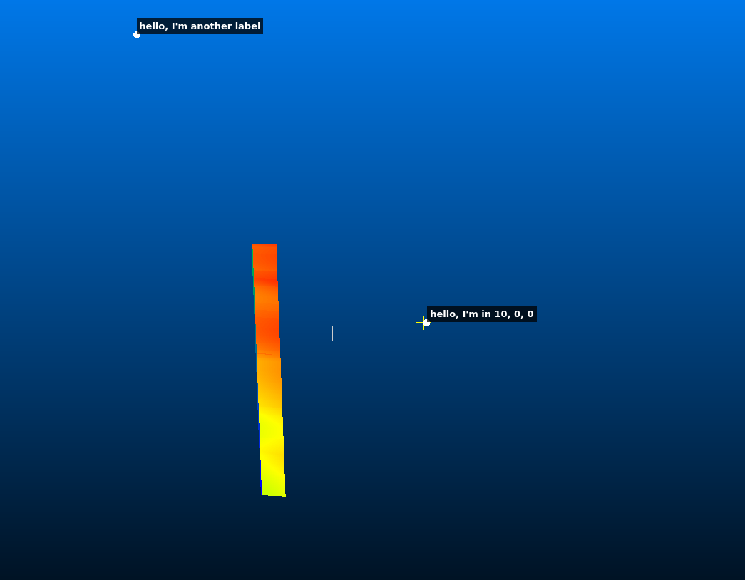

An my results are something like:
It's an advance, but I don't know why my tags don't show the coordinates of the points as in my first post. Also, my labels can't be moved or minimized with the mouse and aren't connected with the marker.
I haven't found what part of the code is responsible for this stuff. Can you (or someone) help me?
