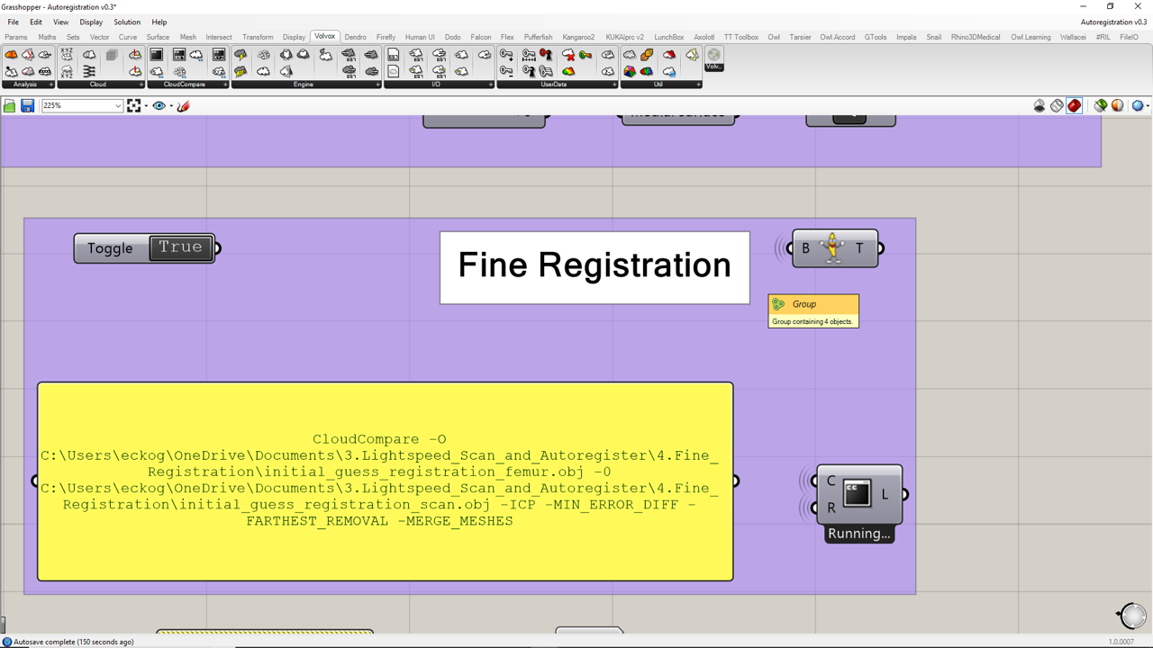

I have a question regarding Volvox call in from GH. I import two meshes to CloudCompare and do ICP without any problems. However, when I try to do the same operation in GH, I get several errors while opening the meshes, and also ICP doensn't execute. Here are my instructions to the command line from GH:
CloudCompare -O C:\Users\eckog\OneDrive\Documents\initial_guess_registration.obj
-0 C:\Users\eckog\OneDrive\Documents\initial_guess_registration_scan.obj -ICP -MIN_ERROR_DIFF -FARTHEST_REMOVAL -MERGE_MESHES

I open obj files from GH mesh format, first error is
[Load] Can't guess file format: no file extension --- I specify the scan.obj so i'm not sure why that's an error, and doesn't happen if I open inside CC instead. THis error is shown twice followed by an opened mesh, so whatever structure it follows, the first two parameters are missing for mesh, any advice on a better type to import? I think I had similar error when I did mesh deconstruct and cloud generated from the deconstruct points.
Same error repeats for the -ICP and other commands I use to specify fine reg parameters.
Thoughts? Ideally, a simple ICP or other functions call example for GH would go a long way. I did quite a bit of search and didn't find any examples to follow for GH based call-outs.

attached is my path. the obj is generated by a save bake command that creates it, so i can use another file type if they play nice with volvox/cc.
