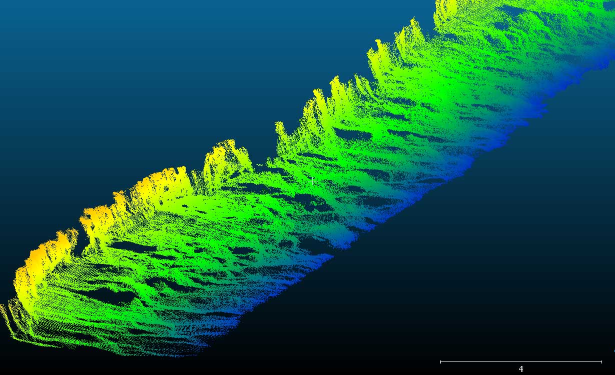

I've acquired a river bank cloud and I'd like to convert it into a surface.
The attachment bank-cloud.jpg is no longer available
The Poisson reconstruction seems to be an appropriate tool as it manages to reproduce well the complex topography of the area. However, when running it, it looks like the tool is trying to interpolate the summit points of the river bank with the foot points, thus generating a quite odd surface:
Is there a way to define boundaries within which I want the program to run? It could also help me preventing interpolation where data is lacking on the "cliff" (where vegetation was present).
Thanks very much in advance
Aurélien

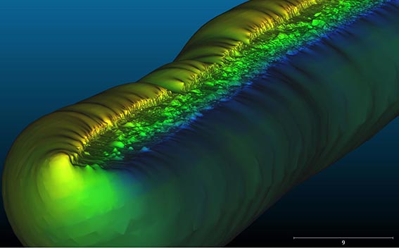

Yes I'm speaking about this big "bubble" (cf image) having no real topographic significance:
As much as possible, I'd like to avoid having to manually segment the cloud. Therefore, I'm looking for a way to prevent CC from constructing an interpolated surface between the top of the river bank (yellow-orange color on the image) and the foot of the bank (blue color).

The density scalar field is output by Poisson. By 'construction' it always create a closed mesh (hence the bubbles). But it can also output the Poisson grid 'density' as a scalar field. The farther a part of the mesh is from the original cloud, the smaller density it will have. This way you can easily remove the parts of the mesh that are too far from the original mesh.
And you can do it very simply by interactively playing with the 'Density' scalar field display parameters (the 'minimum displayed' value = the left circle on the S.F. widget in the mesh properties) and eventually use the 'Edit > Scalar fields > Filter by value' tool to split/cut the mesh where you stopped.

indeed, I did not tick the box "output density as scalar field" when running the Poisson reconstruction.
It works fine, and I've been able to delete most of the irrelevant surfaces.
