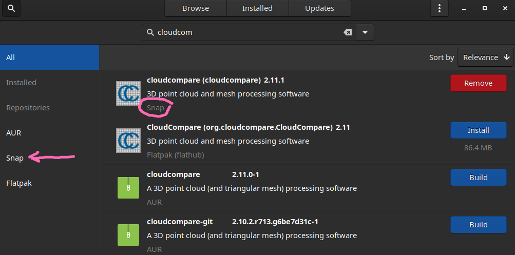

You should enable snap support in Pamac preferences to see snap packages

Thanx @CloudyCloud for the suggestion but I am confused.
In a previous post you said, "Why don't you install the official release version instead of compiling from AUR?"
But even with SNAP turned on in Pamac, I do not have an official release beyond AUR, SNAP or Flatpak.
Then in another post I shared that I could not SAVE in LAS or LAZ on one of the SNAP/FLAT versions.
Could you explain what you see for the "official release that you use successfully?
Currently, this is what I have, which mirrors what you have, I think:
Yet, when I try to open it I get a quick icon, and then it goes away; the app never starts visually.
I get this icon, and then it goes away.
Thank you for the help.
