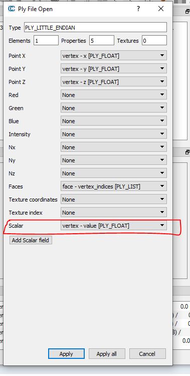

Post by jedfrechette »
You're using the `--density` flag correctly. When you do so it adds a vertex attribute named `value`. Just make sure you select that attribute as a scalar field, see below, when you import the resulting ply in to CloudCompare.

jedfrechette wrote: Fri Oct 30, 2020 11:41 pm You're using the `--density` flag correctly. When you do so it adds a vertex attribute named `value`. Just make sure you select that attribute as a scalar field, see below, when you import the resulting ply in to CloudCompare.
Is it possible to Load the Mesh(PLY File) via CLI specifying Scalar field with vertex-Value??
As mentioned above i am able to load the Mesh File by specifying the Scalar field as shown using UI but i am unable to implement it via CLI, kindly help.
Posts: 8207
Re: PoissonRecon.exe to output density SF CC can use?
Right now, with CLI, the only way for CC to recognize a PLY filed as being a scalar field is that the field name starts with 'scalar'. You can manually add a 'scalar_' prefix to any PLY file with a text editor such as Notepad++ or with a small script (PLY files header is always in text/ASCII mode).

Post by abhishek »
Thank you so much for the response, let me try it out and will update here the results.

Post by abhishek »
It's working, modified the PLY file as mentioned and able to achieve the result. I am adding script here which I used to implement the same:
import plyfile
from plyfile import PlyProperty, PlyListProperty
################################# PLY file Manupulation #############################################
#Convert File format using https://github.com/dranjan/python-plyfile
#Modify Header to read Scalar Density parameter
#Update Ply Header: Modify ----->> "property float scalar_value" from "property float value"
print("Please Wait!!! Transforming File ----->")
file = plyfile.PlyData.read("FILEPATH\\Poisson.ply")
file.text = True
file.elements[0].properties = ()
file.elements[0].data.dtype.names = ['x', 'y', 'z', 'scalar_value']
file.elements[0].properties = (PlyProperty('x', 'float'),PlyProperty('y', 'float'),PlyProperty('z', 'float'),PlyProperty('scalar_value', 'float'))
file.write("FILEPATH\\Poisson_C.ply")
print("File Modified !!!!!")
