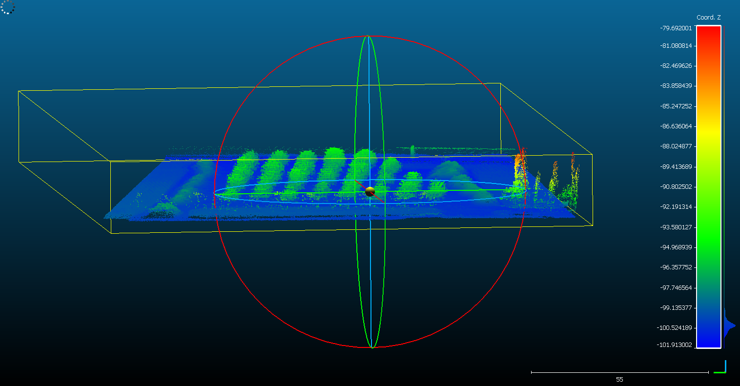

Also, in the attached image from my result I a get Z-values that are negative (scalar bar to the right), I am wondering how it could possibly be that the elevation is negative.

For the negative altitudes, it all depends on the coordinate system in which the points are expressed. It can be a nice geolocalized global coordinate system, in which you can expect zero to be the sea level, but it can also be a local coordinate system, centered on the sensor, in which case you cannot expect anything!

Thank you Daniel.daniel wrote: Wed Apr 27, 2022 6:29 am For the negative altitudes, it all depends on the coordinate system in which the points are expressed. It can be a nice geolocalized global coordinate system, in which you can expect zero to be the sea level, but it can also be a local coordinate system, centered on the sensor, in which case you cannot expect anything!

In the end I realize that the elevation for this location is usually below sea-level, hence the negative Z-value.
