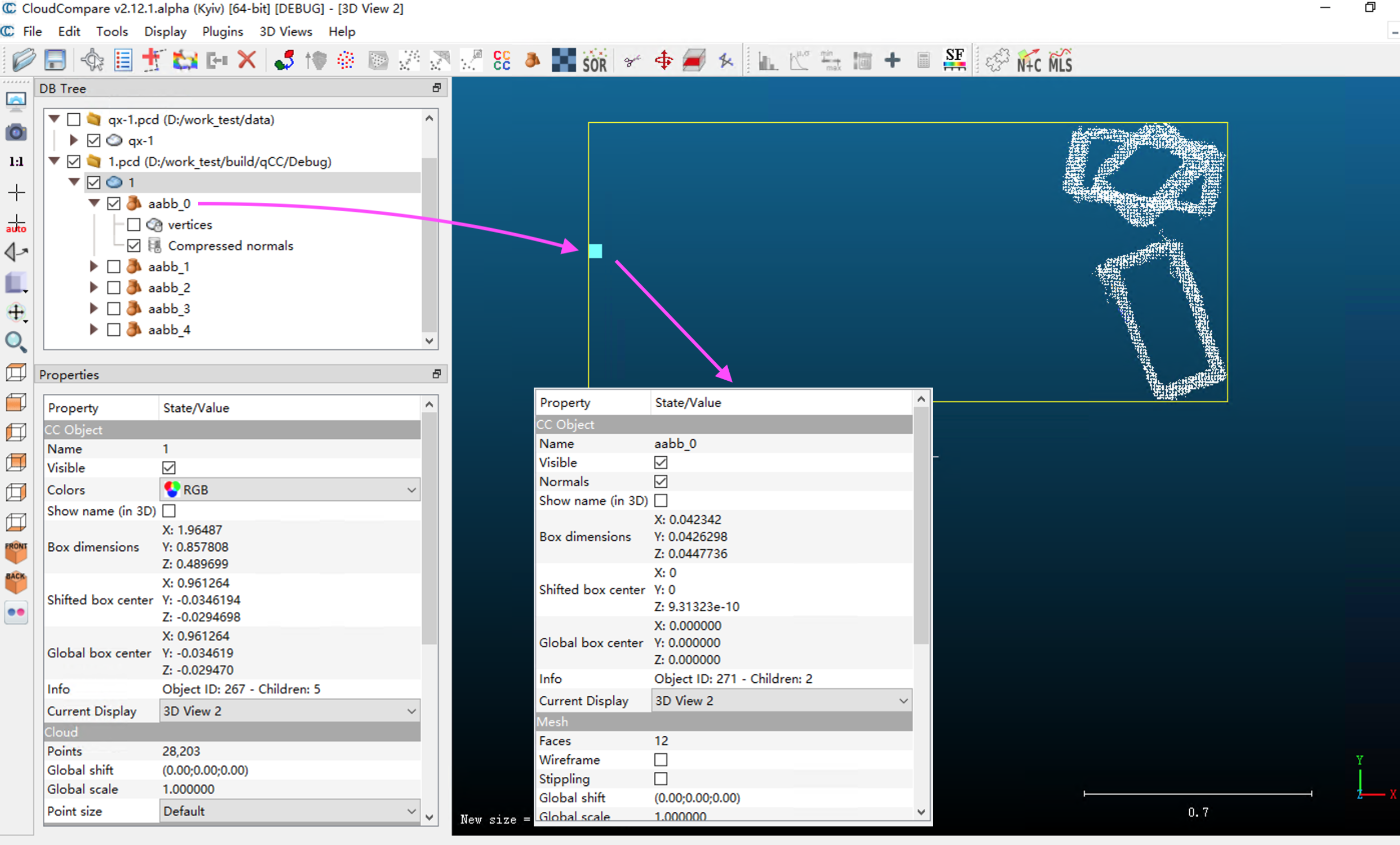

I'm learning to write a plugin to compare two point cloud files, I got some difference point sets between the two point clouds, which I recorded with bounding boxes in AABB and OBB format. In the end, I would like to convert these bounding boxes into corresponding "ccbox"es that can be embedded and displayed at the corresponding position in the point cloud when the user selects them from the DB tree.
But the end result shows that their coordinates don't seem to match, what can I do to get the ccbox to display in the correct position in the point cloud?
Thanks a lot!

ref effect is:

I guess you have to pass a transformation matrix to the ccBox contructor so as to move the box at the right position.
This is the second parameter of the constructor. Instead of nullptr, try:
ccGLMatrix shiftMat;
shiftMat.setTranslation(pos_pt);
ccBox* box = new ccBox( max_pt - min_pt, &shiftMat, boxname);
