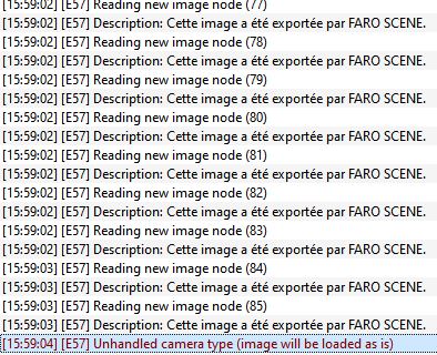

Just to let you know that the native E57 file that comes from FARO SCENE returns a warning in CC console
any idea why ?

So CC doesn't handle all sensor and camera types (so at least the warning is not unexpected).
