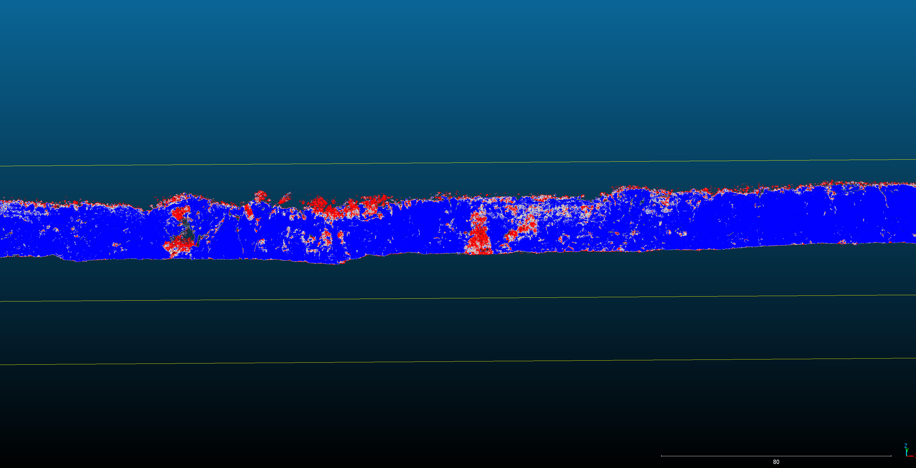

I'm attempting to classify vegetation on a LiDAR survey of some cliffs using CANUPO - I've trained a classifier that works well but I get much different results when classifying in the GUI vs through command line. Using the GUI, I set my confidence level to 0.8 and I get this:
Screenshot 2022-12-15 153352.png (256.01 KiB) Viewed 3388 times
This is the result I'm looking for, however, when I use the command line mode with the same classifier and the same .8 confidence threshold, I get this:

I do see the console registering the confidence level so that's not the problem. I'm now able to get much more similar results but they're still slightly different. In command line mode I get this:
Screenshot 2022-12-19 140906.png (200 KiB) Viewed 3311 times
While in the GUI I get this:
Screenshot 2022-12-19 141108.png (210.21 KiB) Viewed 3311 times
Both are .8 confidence with the same classifier - the command line results are good enough now that I can use them but I just want to understand why they're different - is there anything else I might be missing? Thanks for your help

Hard to tell... What about the Global Shift, is it the same? Or maybe it's just a display thing?
