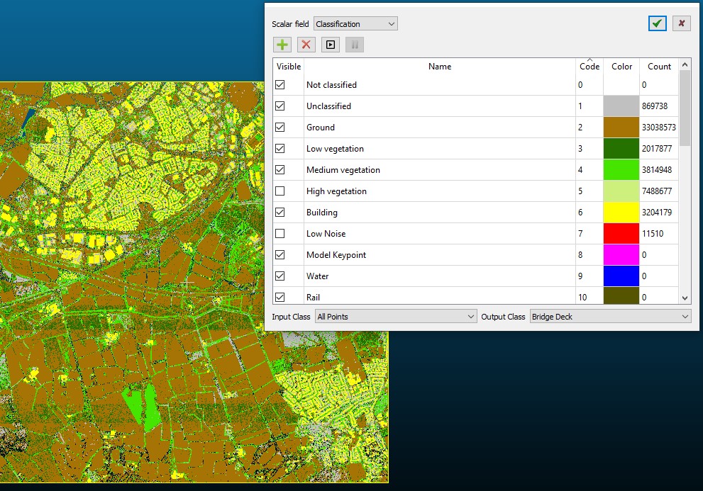

I've got a load of Environment agency LiDAR point clouds that on several projects I've managed to convert to mesh and export, however tall trees/forested areas show up as noise rather than the top of a tree canopy - I have tried numerous things to fix this, but am too inexperienced with the software to get around it.
I've just noticed that the data (seems to) include layers that separate out the point cloud data into various classifications/scalar fields - which is super useful! (screenshot attached).
I was wondering if it is possible to create a mesh with the high vegetation layer disabled? I've tried disabling the high vegetation - which works until I close the layers dialogue, which causes it all to reappear.
Any help on the matter is much appreciated.
CC Screenshot.jpg (246.35 KiB) Viewed 1988 times

Oh I think not sooner had I posted this, I might have cracked it! I think the "filter by value" gives me exactly what I'm looking for?
