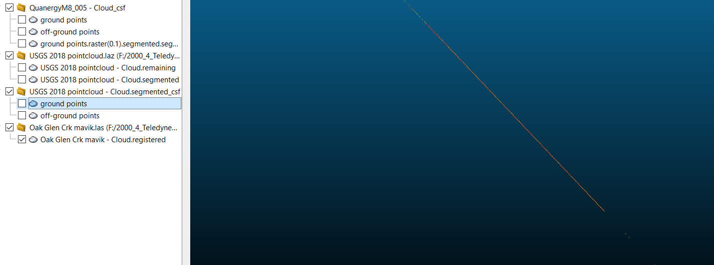

Cloud Point showing up as a straight line
Post by LiDoom »
For some reason when loading this point cloud file it shows up as a straight line, I can zoom in and out, but I don't see the full extent of the cloud.

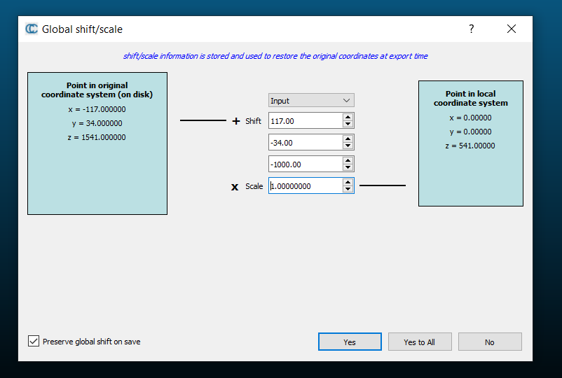

Make sure that you are using global shift during opening, if cc revommends it. It might be caused by large coordinate precision loss.

You'll see that right away by considering the scale/values in the X, Y and Z columns (angular values will be much smaller, and almost all the same)

HeadLess wrote: Sun Apr 28, 2024 7:46 pm Make sure that you are using global shift during opening, if cc revommends it. It might be caused by large coordinate precision loss.
here's what I see when importing. For some reason I don't have an issue when opening up this point cloud in Quick Terrain Modeler.
Re: Cloud Point showing up as a straight line
And what the bounding-box looks like once you've loaded the cloud?
There's good chances that Quick Terrain Modeler does manage properly geographic coordinate systems...
