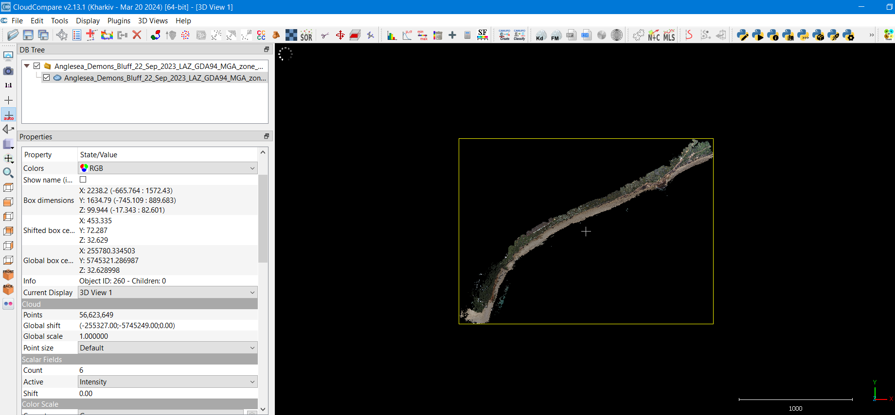

Whole cloud

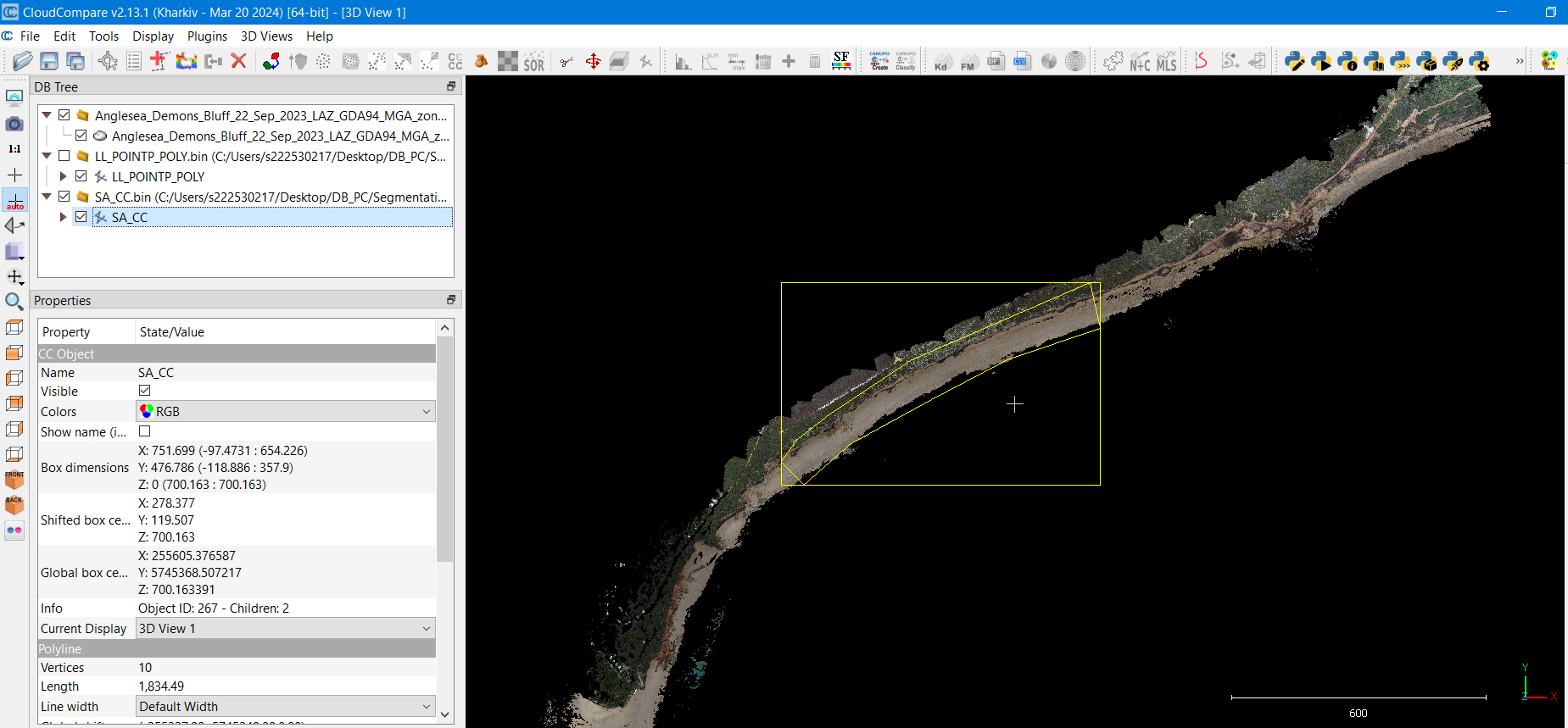

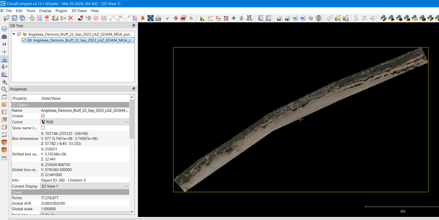

Cropped cloud - Z axis
cropped cloud.PNG (333.34 KiB) Viewed 15631 times

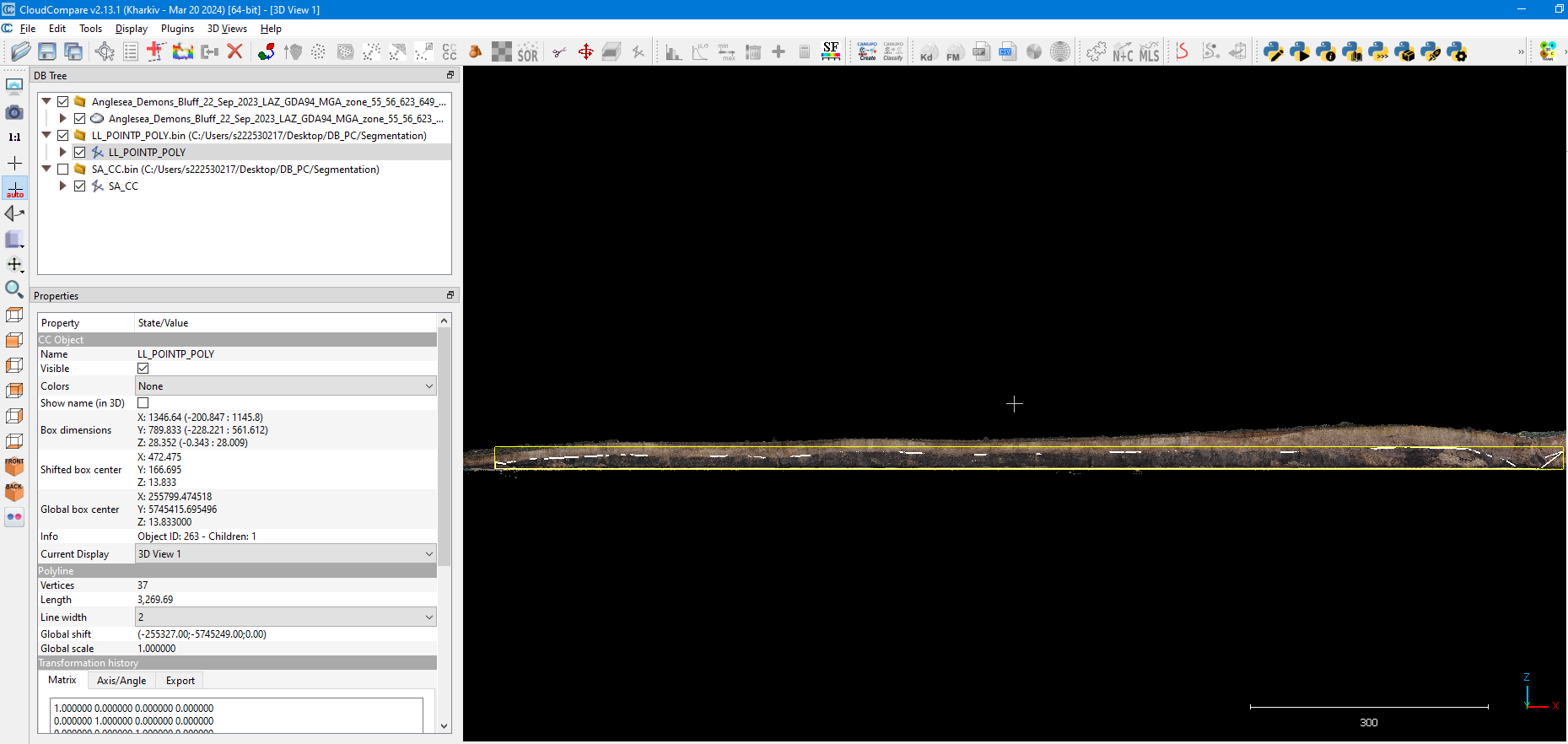

Unsuccessful crop polyline
Failed crop_pointpicked.PNG (235.81 KiB) Viewed 15631 times

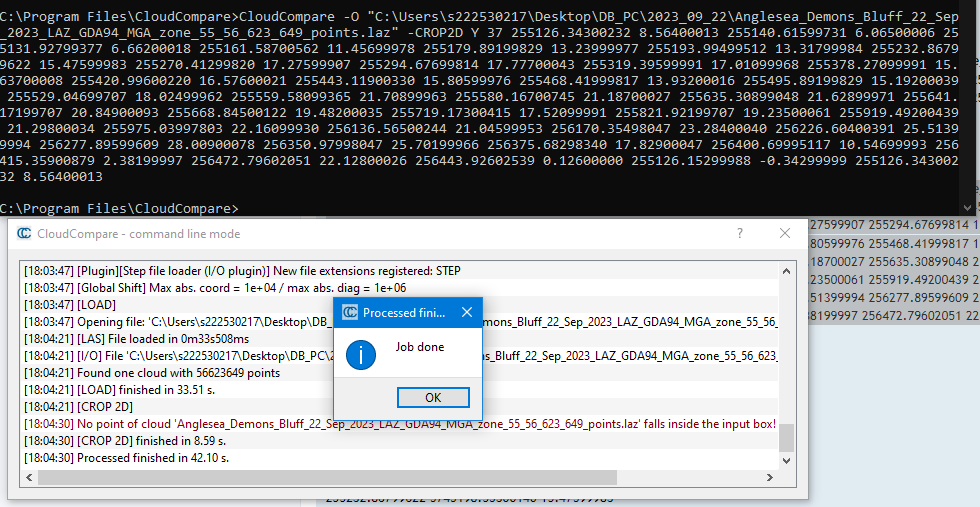

Error
