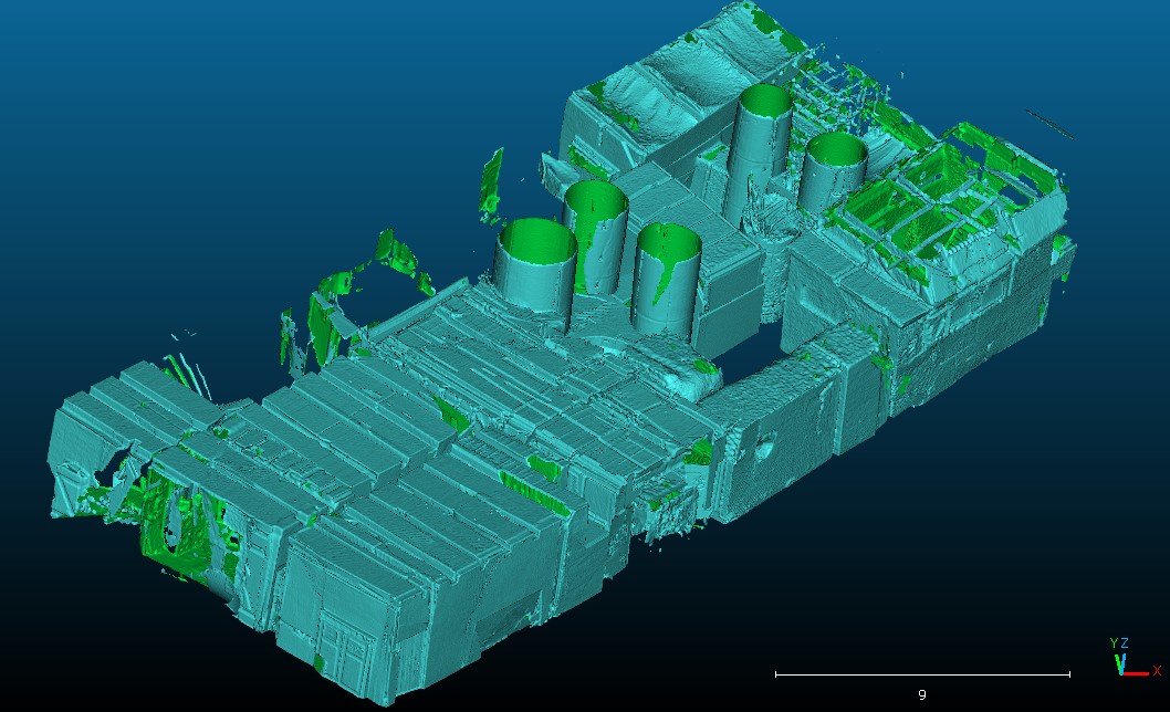

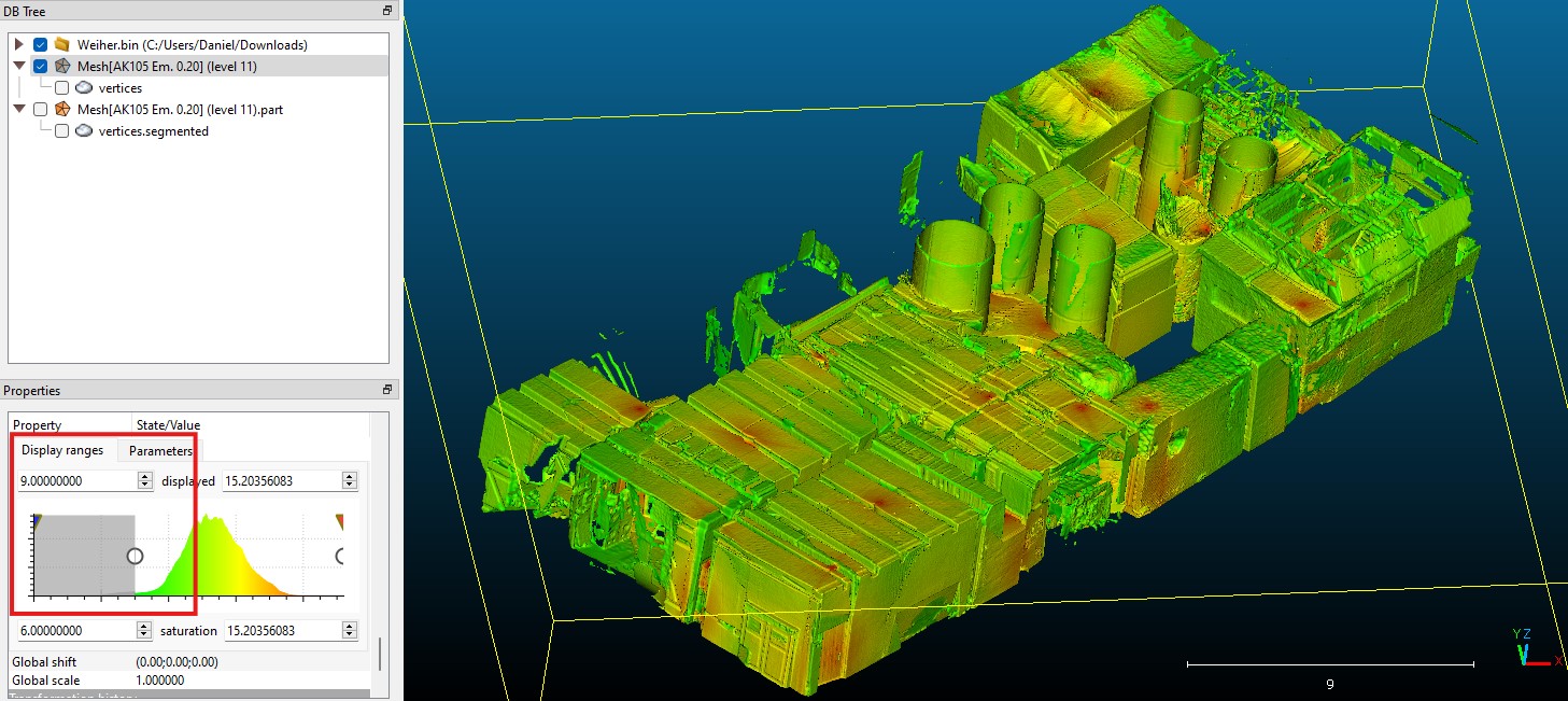

3) I then used the output "Density" scalar field, to remove the triangles that are too far from any point, and might not be correct (I'll let you play with it to see where you want to actually set the threshold):
4) You can then use 'Edit > Scalar fields > Filter by value' to create a new mesh (use the 'Export' option to create a new mesh with only the visible triangles)
5) You can remove the scalar fields on the resulting mesh (Edit > Scalar fields > Delete all!)
6) Eventually, you can export this mesh to any format you want (PLY, OBJ, STL, FBX, etc.). Mind that only the PLY and FBX format can keep the colors, as they are 'per-vertex' colors. Poisson Recon doesn't generate textures that could be associated to an OBJ file. And STL doesn't support colors at all.
