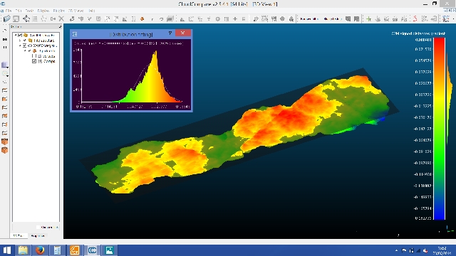

Hi Daniel, i 'm writing my thesis but i still have few questions for you ;)...
- which unit of measure has the gradient ( degrees?)?
- why the "gauss: mean" value is equal to 0.0000? when CC compute the distance between a fit plane and its cloud returns me a Gauss distribution but it don't specify me the mean Gauss value

here one photo for Gauss: mean value
- dist_stat (640x360).jpg (156.48 KiB) Viewed 7951 times

- the gradient is expressed in 'units of the scalar field' / 'units of distance' (because we compute something equivalent to a difference of scalar values divided by a distance between points)
- when we fit a plane on a point cloud we compute the "mean squares" solution. This solution is such that the mean distance of the points to this plane is 0 by definition.
- you can ask for the Gaussian distribution of a scalar field any time by selecting the cloud that hosts the scalar field and then calling the "Edit > Scalar fields > Compute stat. params" method (then simply select the "Gauss" distribution). The scalar field must be the active/visible one.
You should also display the Console (F8). Interesting information is displayed in it from time to time (such as the distribution parameters, etc.).
