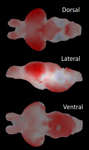

Post by danhps »
Here is one heatmap resulting from a brain case-brain comparison. I want to register a bunch of heatmaps similar to this one together and somehow "average" the values to get an average heatmap.

Re: Comparing cloud compare outputs
Ok, interesting. And I guess the shape of each brain changes for every animal? If it doesn't change too much, you could maybe use the 'Edit > Scalar fields > Interpolate from another entity' to transfer one set of distances from a brain mesh to another (you'll have to rename the sets of distances so that they don't clash when interpolating them).
And then you could compute the average scalar values by summing them and dividing by the right number (either manually with the 'SF Arithmetics' tool- which might be long! - or maybe look at how to automated this with Python or the command line tool if there are a lot of brains).
But the interpolation might induce some big errors if the brain shapes are quite different.

Thanks, Daniel! The shape doesn't change too much, but I guess it is all a matter of degrees. It sounds like it might work for two brains at least, I'll give it a try. Do you think it would work iteratively, for many brains, or would the interpolation errors compound with each additional comparison?
As you'll interpolate all the brains to the same one, the errors won't pile up. And in the end it might even be 'average' by definition...
