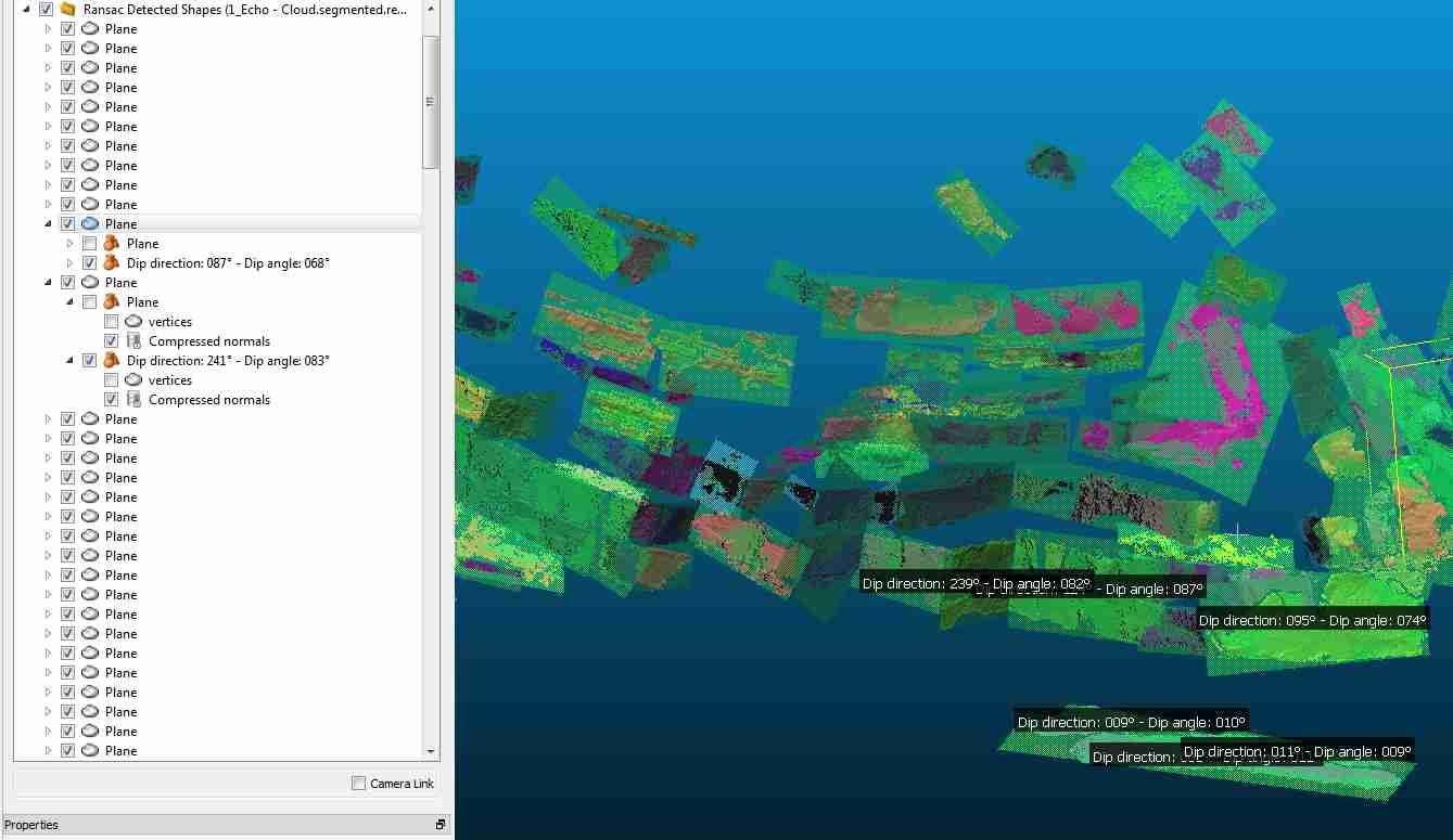

Hello Daniel,
first of all I want to thank you for this super piece of software and for your support. I use the software (Cloudcompare & the Ransac Shape Detection Plugin) for my master thesis in applied geology to detect rock faces in point clouds.
To my question: How can I export the "dip direction & dip angle" to a .txt-file or store the values in a scalar field?
Some details to my proceedings so far: I used the "Ransac Shape Detection" which gave me seperated pointcloud-classes and their planes. On these data I used "Tools/Fit/Plane" to get another plane, which has the "dip direction & dip angle" in its "name-field". As I cannot import the planes to other availible software, I want to export the values in a .txt file or in a scalarfield.
I used a "Riegl TLS" and "Riscan Pro" for scanning and data registration. Further proceedings I did all in Cloudcompare.
- Result of Ransac Shape Detection
- Ransac Detected Shapes_s.jpg (63.24 KiB) Viewed 21866 times
Re: Export Dip direction - Dip angle from planes
Hi and thanks for the (nice ;) feedback.
I'm afraid there is no mean to export this information right now (moreover, it's only saved as the entity title, i.e. a string not even digits).
The simpler way would be to 'hack' the 'Fit plane' method (MainWindow::doComputePlaneOrientation). Do you think you can compile CC on your side? This way I could give you the few lines of code that should be added to output this info in a text file for instance).

Well,
If you want to save the vertices of the plane or the polygon, you can do something like that:
I assume you know how to open a new text file. For each valid entity (i.e. in the 'if (cloud)' block), use the same code as before but with another name. Typically something with an increasing index:
This will create one file per entity next to CC's executable. Let's assume also that the stream for each file is named 'vertStream'.
If you have a plane: (i.e. in the 'if (pPlane)' block)
If you have a 'facet', you can use the same code but the vertices cloud is fetched differently:
If you have issues with this, don't hesitate to send me your 'mainwindow.cpp' file.
QString outputFilename = QApplication::applicationDirPath() + "/" + QString("vertices_%1.asc").arg(i);
ccGenericPointCloud* vertices = pPlane->getAssociatedCloud();
//for each vertex
for (unsigned v=0; v<vertices->size(); ++v)
const CCVector3* P = vertices->getPoint(v);
//save the vertex coordinates on a line (x,y,z separated by space characters here)
vertStream << QString::number(P->x,'f',12) << " ";
vertStream << QString::number(P->y,'f',12) << " ";
vertStream << QString::number(P->z,'f',12) << endl;
ccGenericPointCloud* vertices = facet->getContourVertices();
