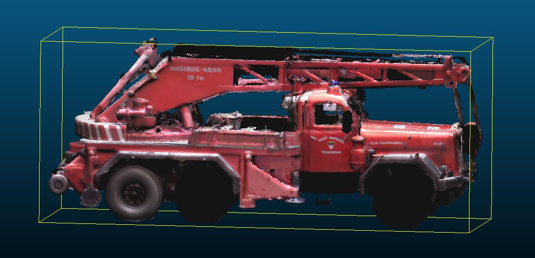

Thanks for your answer! I'll try that later. It seems that I'm a patient waiter... but I just wanted to see how long it will take if I don't change anything at the settings (and I've already started when I wrote the question). Well, it was about 6.5 hours and now I have a result to show... I have to admit, I'm not really impressed. Are the black parts a cause of wrong normals? Is it possible to change them manually?
I'll test the computing with different kernel radius settings, maybe it will give an better result. Do you think it could help if I perform an HPR before the computing?

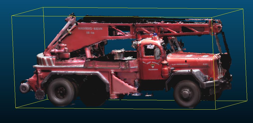

Re: Computing normals is terrible slow
Nice scan ;)
The kernel is clearly too big (it gives a smooth effect) so I think the black normals are just wrongly oriented.
Did you tell CloudCompare to resolve the normals orientations? (normally CC asks for this at the end of the process - otherwise you can launch it manually with 'Edit > Normals > Orient Normals > With Minimum Spanning Tree').
And if the cloud is noisy (especially with overlapping scans that are close to each other but with a slight shift due to a too coarse registration for instance) then you should definitely resample the cloud (with Edit > Subsample).
P.S.: did you understand why you miss some normals while all points come from DP files?
P.P.S.: don't hesitate to share the (DP) files with me if you want me to try on my side and give you the best sequence/parameters

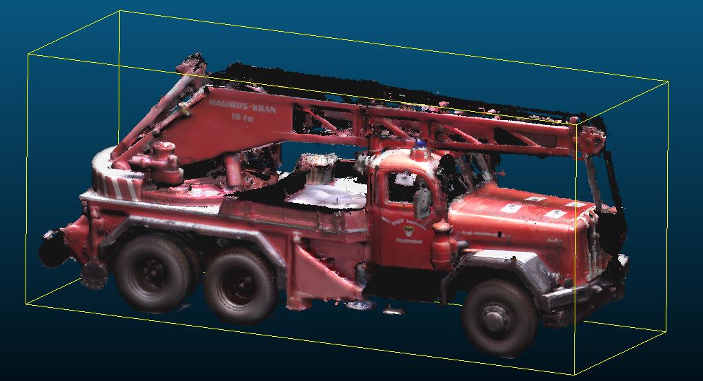

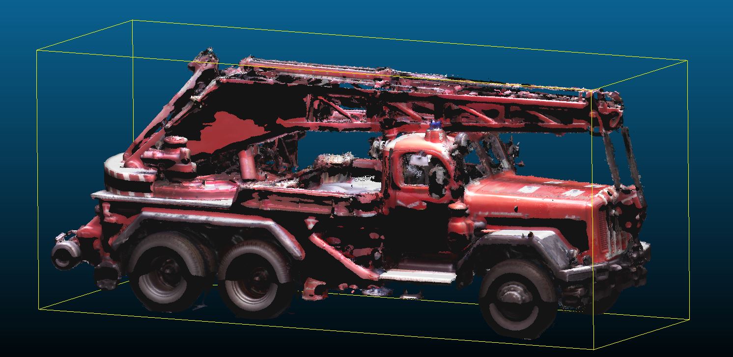

Thanks! :)
I've just tried and tested some calculations with the "Orient Normals" function and got several results. None of them is completely fine, but I'm getting close to. Special thanks for your tip with the subsampling method, I've already searched for a function like this!
I don't know why it hadn't saved the normals, maybe I forgot to calculate them when I've opened one file (it was created by combining 6 single scans). In other files this has worked pretty fine.

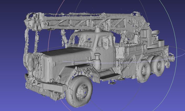

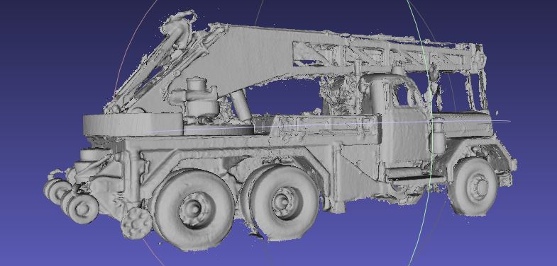

And by the way, this is what the calculated Mesh (Poisson Surface Reconstruction) looks like (with double side lightning, as some parts like e.g. the wheels, and the tow of the crane have still wrong normals)
