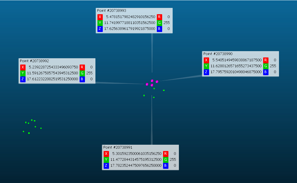

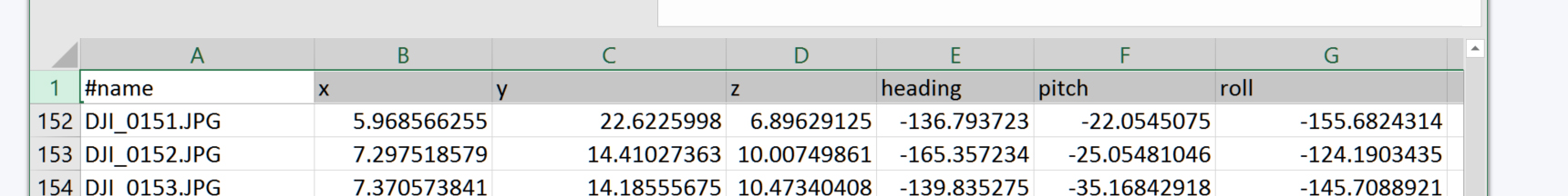

I have managed to export a .csv file from Capturing Reality which gives the filename,x,y,z,heading,pitch and roll values. When I load the xyz file to viewer and look at the point of a camera position the 2 values are not relative to one another. The image I am comparing is DJI_0151.jpg. This shot shows the position from CCViewer while the other is the csv x,y,z co-ordinates from the exported csv.
Any ideas as to why the 2 sets of data do not seem to match?

In the CSV file, the 'x, y, z, heading, pitch, roll' are probably describing the camera position? (i.e. optical center + camera orientation)
In this case, you have to consider the 'cone' of vision of the camera to be able to determine if a 3D point falls inside or not. And sadly you are missing some other information to do this (the field of view or equivalently the focal length).
