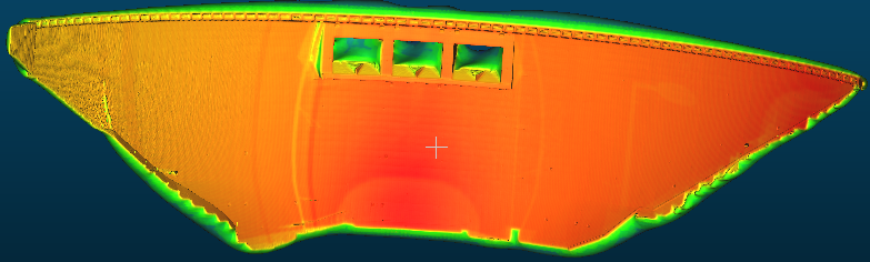

I wanted to apply the PoissonRecon tool on a pointcloud representing a dam. Therefor I computed the normals with these parameters:
- quadric model (good for curvy surfaces like the dam)
- Radius = 0.051 instead of 0.041 (0.041 was the auto-computed radius) I understood a bigger radius was good to get better normals
- minimum spanning tree with knn = 6
Computation took a lot of time because of my computer but the normals were good (white and not black).
Then I used the PoissonRecon tool with octree depth = 11 and with the output density as SF (SF = scalar fields, right?)

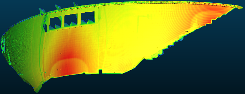

The 3 attached pictures show the result. The front side of the dam is really nice I guess (red/orange part) except for the left side but I know it's because of the noise. And the back side of the dam is really strange. I only scanned the front side.
Could you explain me why the reconstruction is really weird?
(I think you are french, so am I. You can answer in french if you want)
Best regards,
Cyril.
Re: CloudCompare mesh adds unwanted surface
Poisson always create a closed mesh by default. You then have to reduce its coverage.
See the documentation about PoissonRecon: http://www.cloudcompare.org/doc/wiki/in ... n_(plugin) (especially the section about Using the output density).
