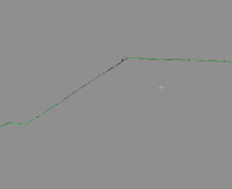

I have another problem. I attach a screenshot
Re: Problem with Cross Section tool
Have you asked CC to 'split contour(s) on longer edges'? In this case you probably to reduce the 'Max edge length' parameter, or simply disable this option.
