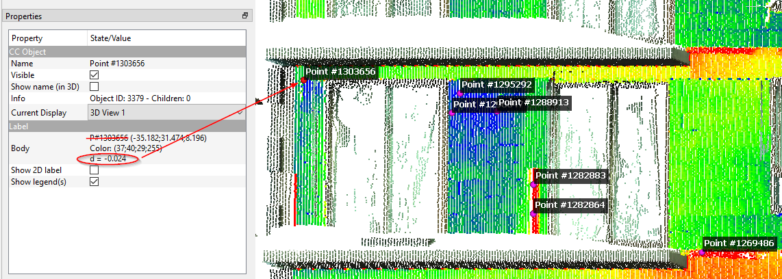

Thank you, it's much better. Is there any way to break off this "C2M...=" and leave the value alone?
no c2m.png (32.38 KiB) Viewed 6832 times
Re: How to change the label color?
Not automatically... But you can rename the scalar field (with Edit > Scalar fields > Rename) to have it much shorter.

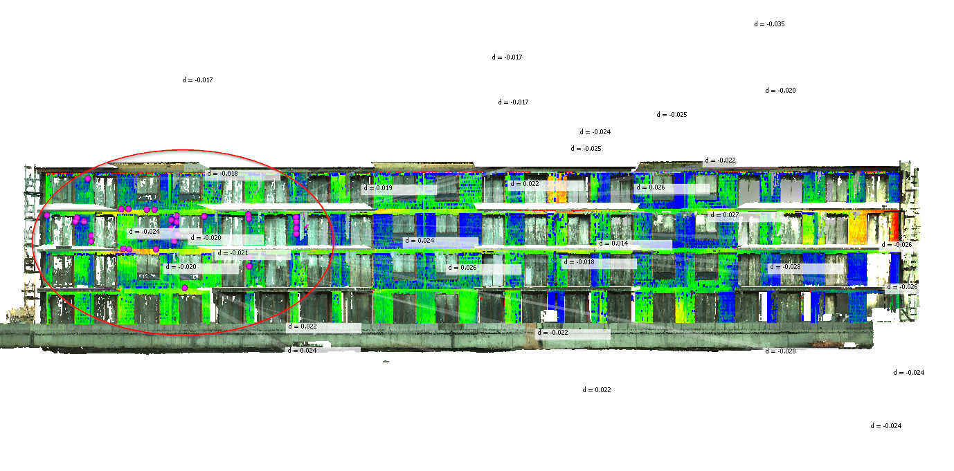

Thanks, works great! Next question: is it possible to stick point's description to point? When I move view, location of descriptions is changing, it's burdensome when I have longer object to describe and then render to file... Example:
Descriptions flew away when I changed view to move forward.
So maybe a simpler way to do what you want to achieve is to switch from the display of a 2D label to a simple 'legend'.
Just uncheck the 'Show 2D label' option and check instead the 'Show legend(s)' option.
