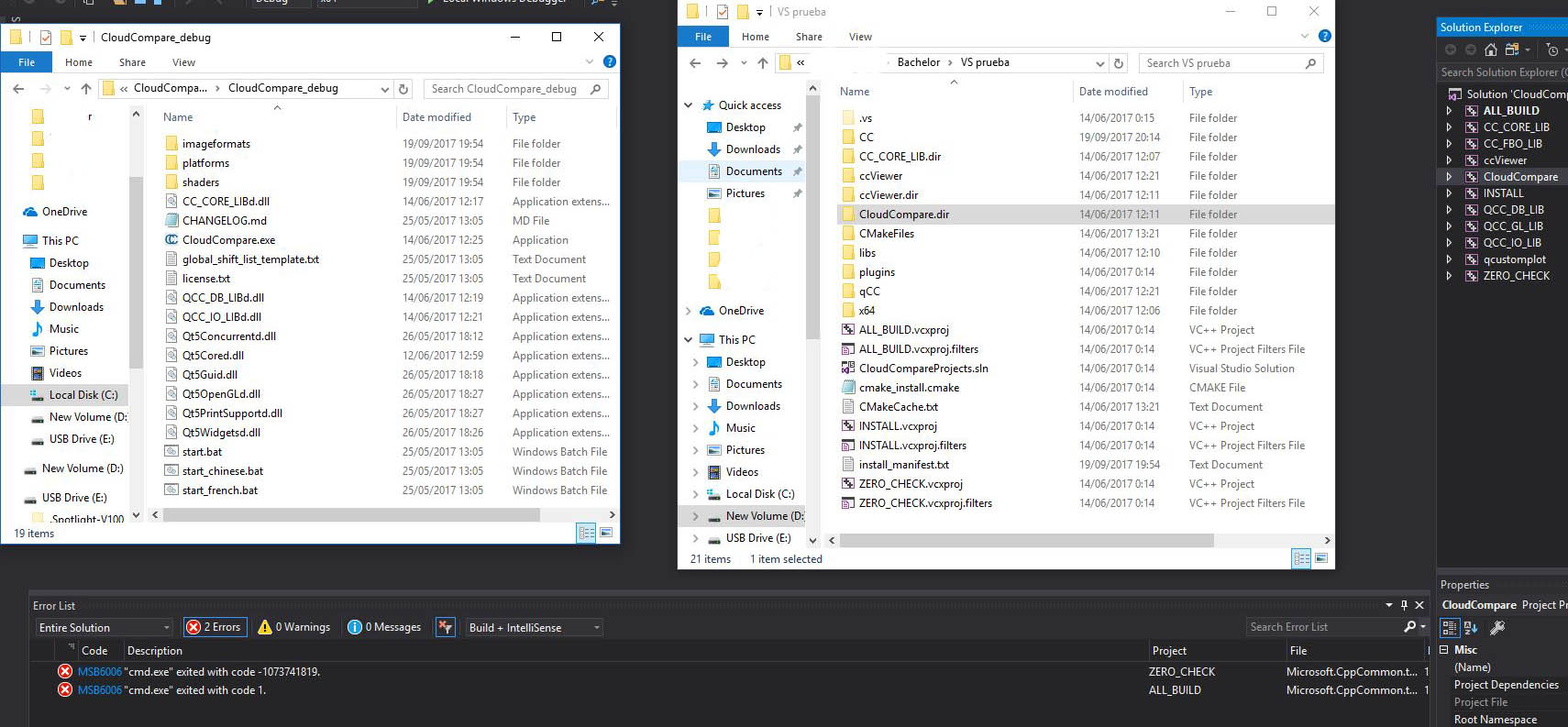

I'm forced to implement it in C++ now and I'm completely lost.. Now when I compile, it shows me 2 errors and creates a Files in CloudCompare_debug (as shown left in the screenshot).les245 wrote:Thank you very much, that solved the problem. But now, as I try to compile the INSTALL project, I get 3 errors...
What I need to do is get a mesh of a point cloud. I got it using the Delaunay feature in CloudCompare and now I have to automate it, so I thought it would be easy to program it in C++ using a library but I'm completely lost and overtaken. I have never done anything similar (I learned to program in C# but never used many libraries). Could you point me in the right direction or tell me if what I'm trying to do is achievable?
I attached a screenshot of the errors. Thank you very much again.
I'm new to C++ since the only thing I ever learned was C#, so I'm sorry if this is some basic stuff..
I think it shouldn't be that complicated: I only need to load a point cloud, use Delaunay and save it as STL

Hum, hard to tell with only this view.
Are you only 'compiling' the CloudCompare projet or are you trying to run it here? Looking at the error, I would say that compilation is ok, but it fails to run?
If that's the case, then you must actually compile the 'INSTALL' project and then run the installed version of CloudCompare (see the specific section of the BUILD.md file, about Visual Studio).
Otherwise I'll need more information...
