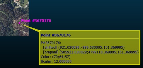

When the cloud is shifted by CC, the shift information is kept with the cloud (you can look at the cloud properties to check that).
When you spawn a label (if that's what you are speaking about) you should see the point 'shifted' coordinates as well as the 'original' ones: Or are you referring to something else?

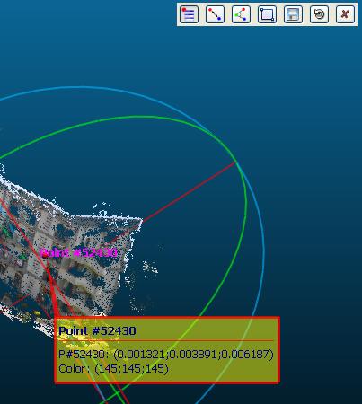

Yes, I was referring to the label display problem. The label displays only the shifted coordinates. I don't know how to add the other attributes into the label..

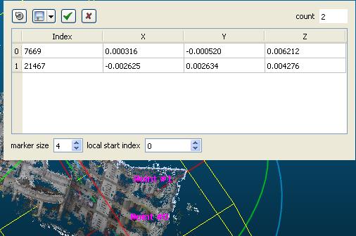

The other problem is in point picking list. When I pick a point, the shifted point are displayed in the point picking list. Even if I save this list in .txt format, then also the shifted coordinates are saved. I want to save the global coordinates of picked points..

And for the other issue, the absolute coordinates are not disabled by default (I'll add something regarding this in the TODO list) but the latest beta should fix the fact that the global shift was not applied at export time.

Also the other problem of point picking list is also resolved with the new version.
