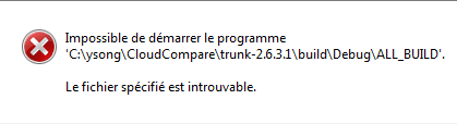

Posted: Thu Jul 21, 2016 11:41 am
by Lucien
daniel wrote:Well I guess you could get more information on a Visual Studio forum:
I couldn't debug as you said
. I got this error when use F5.
If I generate just the INSTALL project, it compile without stop.
Re: debug the new plugin
Posted: Thu Jul 21, 2016 11:56 am
With Visual you have to set the default startup project. Right click on the 'CloudCompare' project and set it as 'Startup project' ('Définir comme projet de démarrage' en français).
But be sure to 'compile' the install project anyway and set the default executable of the 'CloudCompare' project as the installed one.
