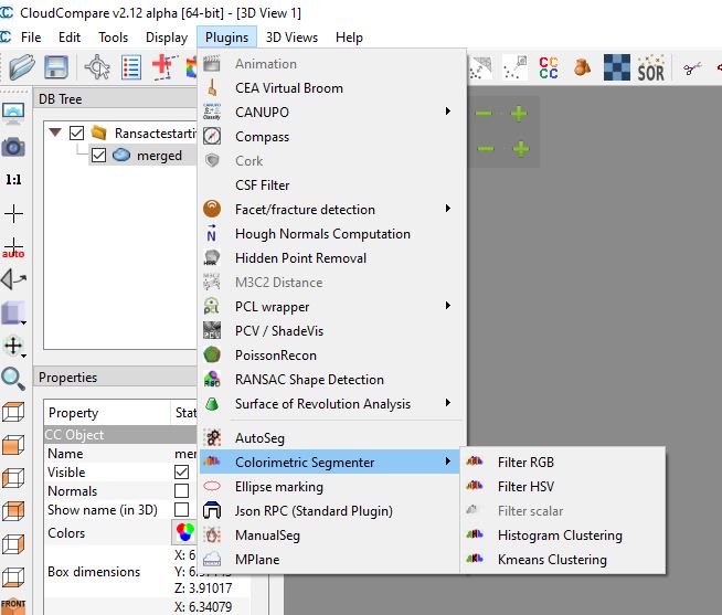

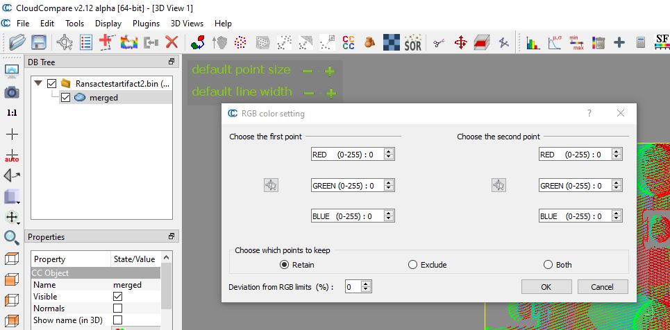

Re: select / delete points by color
We have the colorimetric segmenter for this now
