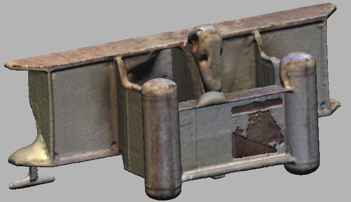

I have point cloud which was loaded up to CloudCompare and calculation of normal was applied.
Then I have used Poisson Recon plug in to mesh my point cloud.
Once open in CloudCompare I have noticed plugin add mesh at space where was no points. To better visualise I am attaching rendering of this in Inventor.
Could you please advise how to get proper mesh on point cloud I am using? Kindly please advise any step...

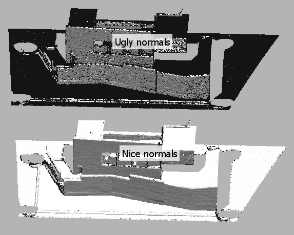

1. Here is what nice normals should look like:

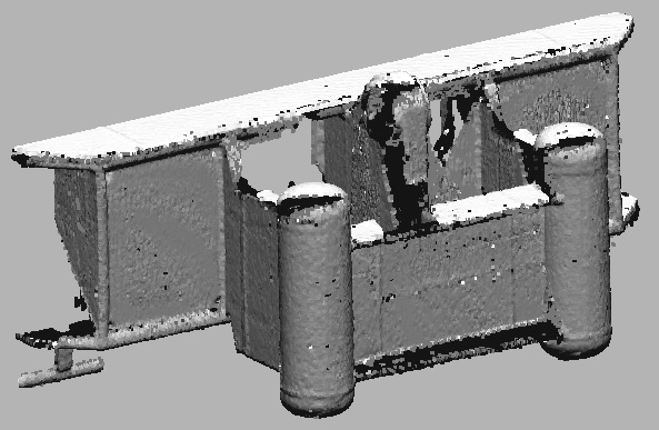

And regarding your cloud: it's quite noisy so you'll have to denoise it a little bit first in order to get not-too-bad-normals (you can increase the points size to see the noise). You can use the SOR filter to do this (see 'Tools > Clean > SOR filter' - leave the default parameters). Then compute the normals and when asked about orienting the normals, say yes and use a low number of neighbors (3 for instance). Here's what you should see:
(note that it's not perfect yet, but it's hard to get a better result with a noisy and incomplete scan, especially on the front part where the two sides are very close and almost 'connected' due to the noise)
