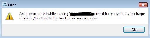

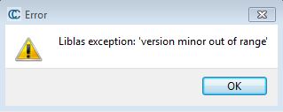

I receive this error message when dropping a las file in ( both v2.6.2b and v2.6.0):
Displayed first....
Displayed first....
after clicking OK here, displayed this one:
Displayed after clicking OK at first
The same thing thing occurs if I compress the las file to laz with laszip.exe, the .laz file also drops this message.
Thanks!
Re: Liblas exception: 'version minor out of range" error
Indeed, this is because Liblas (the library we use to load LAS files) doesn't support the version 1.4 of LAS/LAZ format (the one with full-waveform).
If you don't have any full waveform data, I bet lastools must have an option to downgrade the file to version 1.3?
