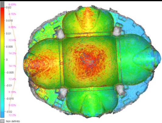

I've done a survey of an old church, with two different metods, the first one it's by taking photos from a drone, the second with laser scanning
So i've one point cloud created on photoscan processing the photos i've taken. CLOUD A
the second one it's a point cloud created merging all the point clouds of the scans. CLOUD B
i've even a 3rd cloud that's created merging CLOUD A with CLOUD B.
Now i want to do an analysis of CLOUD A, and CLOUD B, i'm interested to see the distribution of point distance in each cloud so how the density change in every part of the church.
you can see an example of what i'm trying to do in the attachment.
Can you help me?
thank you for your help

first of all thank you for the answer and sorry for my english.
If you look to the image in my first post, it shows a map of the distance between the points in the cloud and on the left we can see the % of points in that distance range (i.e. 14.2% of the points are between 0 and 0.005)
I want to do the same thing with two different clouds.
I don't understand if i've to use distance between two clouds to do that, i've read all the wiki but i don't understand if this tool tell me what i want or if it tell me only the distance between the two clouds that it's useless to define the quality of the two clouds...
thank you and if you want other explaination just tell me :D

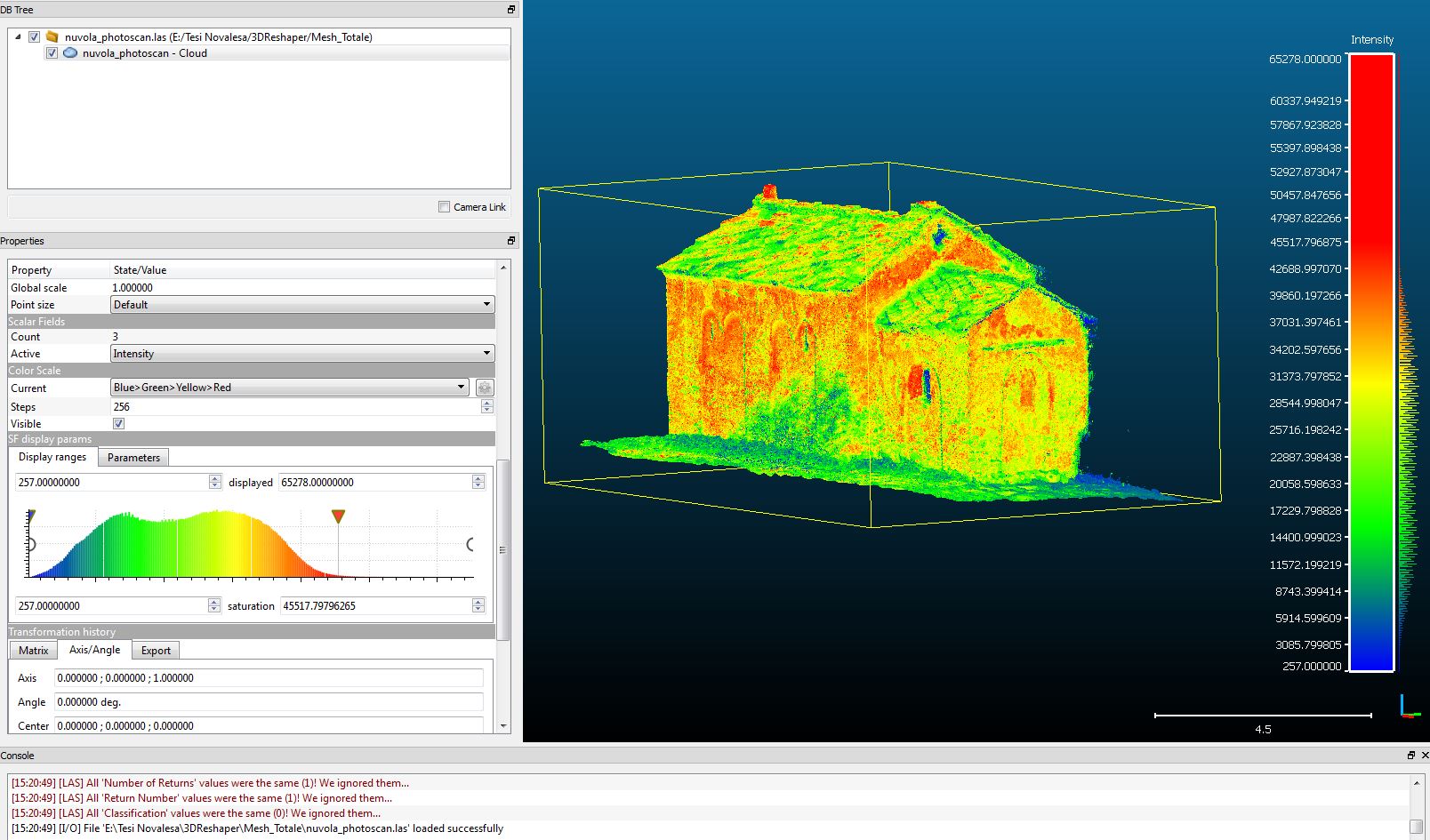

OK i'm trying to do this, but in the scalar fields panel i can choose only between: none, intensity,point source ID, scan direction.
Even in histogram i see a graph of the intensity and not of the distance
i give you a screenshoot
Sorry again for the obvious questions
- Cattura009.JPG (246.03 KiB) Viewed 10680 times

the point is, that i don't want to show the distance between the two clouds.
what i want to show, like in the image that i've posted in the first post, it's the distance of each point of the cloud from the neighbours points.
for example, if i've 10% of the points that have a distance from the neighbours of 1 cm
i've 40% of the points that have a distance from the neighbours of 0,2 cm
and so on...
and so on...
