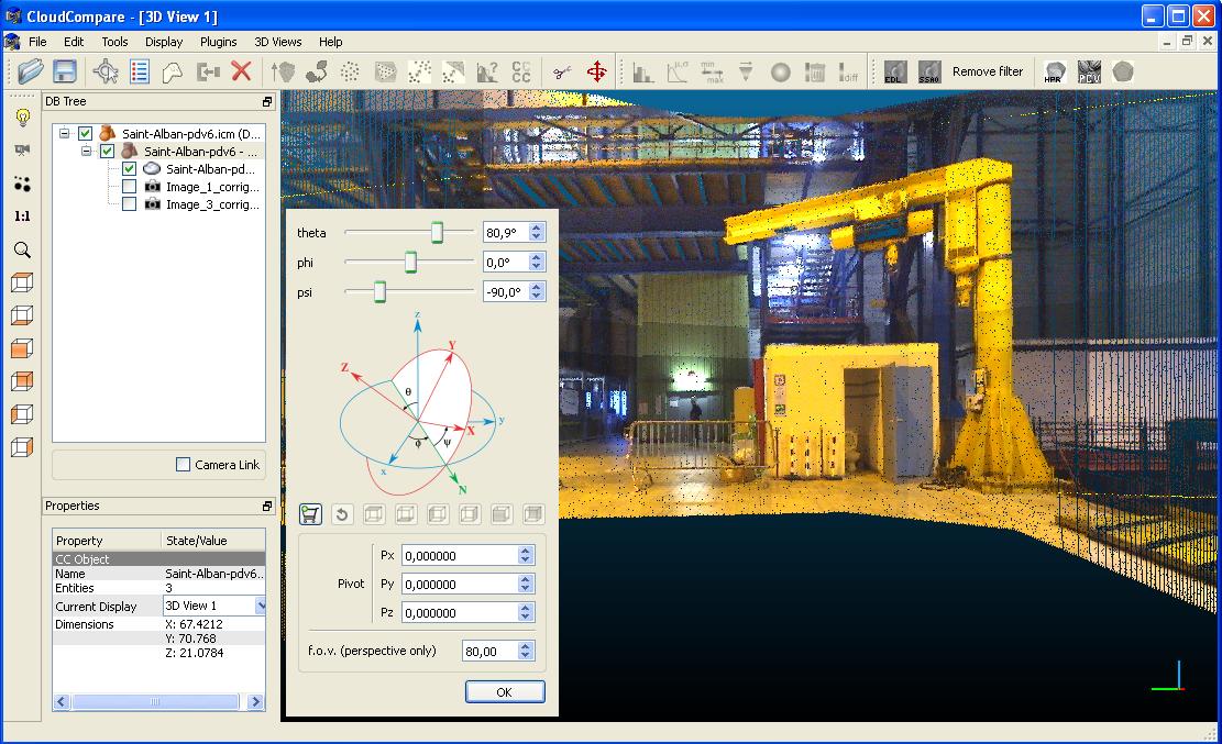

the new version of CC (27 Jan. 2011) now includes this 'bubble view' feature (see attached image):
- open your cloud
- enable the 'viewer based perspective' mode (F4)
- open the camera parameters dialog
- the 'pivot' point in this particular mode is now the camera position
- you generally also have to set the camera orientation properly (generally 'psi'=-90° and 'phi' = 0° for a point cloud directly output by the scanner)
- eventually you can play with the f.o.v. (field of view) parameter
Give me some feedback,
Daniel
- open your cloud
Daniel
- cc_bubbleView.JPG (158.95 KiB) Viewed 197175 times
Re: Bubble view, or View Based Station
Hello Daniel, it works quite well, thanks a lot.
The problem is that when you want to do a segmentation for example, the camera comes back automatically to a centered perspective, but it's maybe another stuff to segment with this viewer based perspective....
Anyway, thanks for adding this functionnality.
See you,
JF
