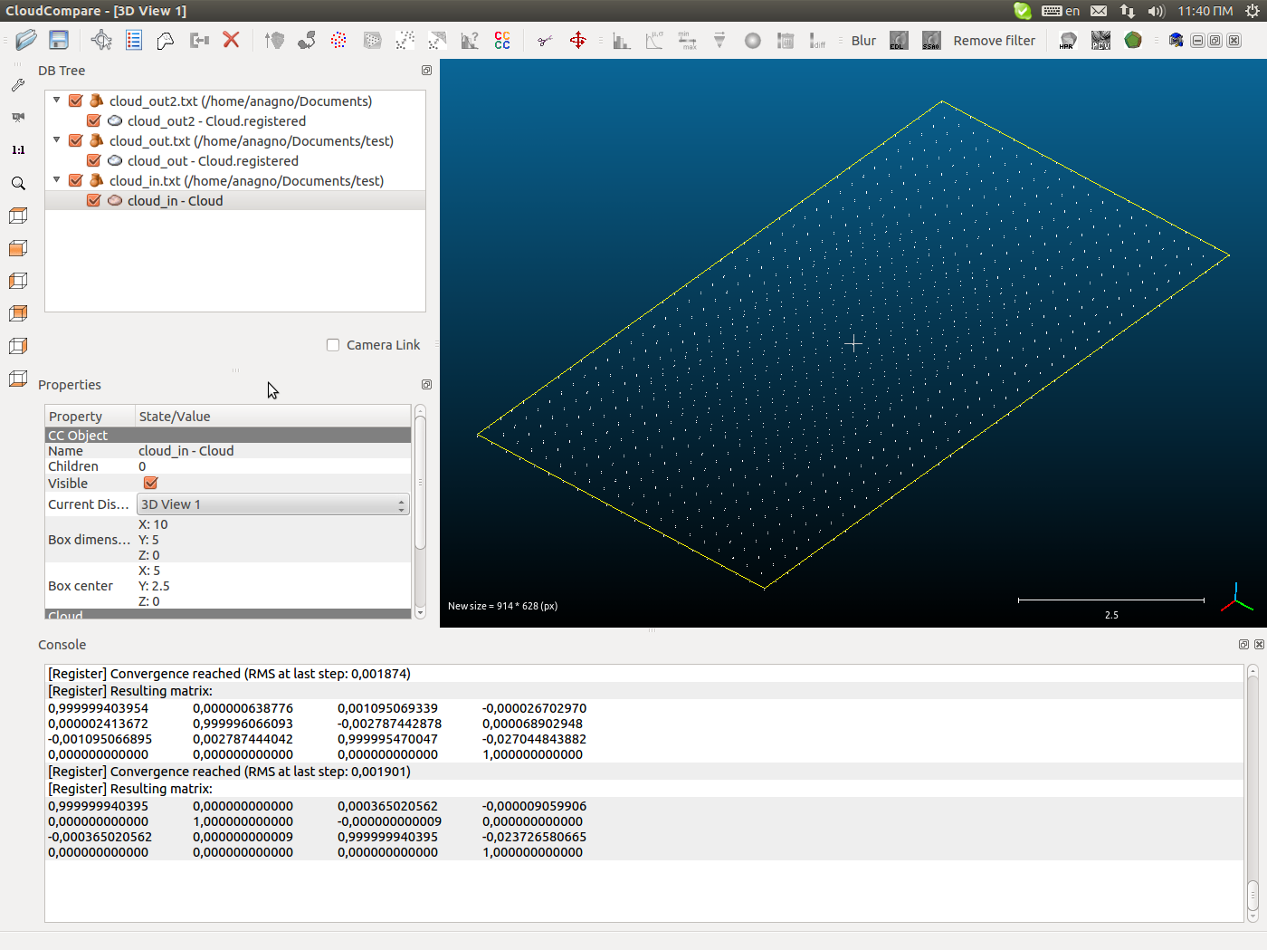

If yes then could someone help interpret some results i get from the algorithm ??? I want to test the icp algorithm to see if it is capable of detecting deformations on two point clouds. For this purpose i created a grid of points and afterwards an area of surface of the grid was chosen to be raised by 0.10m uniformly at the z-axis.
Then i move a little bit the raised area and i expected to get fairly the same results but that was not the case. (you can see the results in the screen shot i attached)
Also there is a rotation matrix when i haven`t rotate at all the grid.

Indeed, the "register" tool is based on ICP (with an optional random points picking scheme at each iteration for big clouds, but this is visibly not the case for your example).
In a general point of view, standard ICP works poorly on flat/smooth surfaces (not at all in fact). Depending on the clouds limits and sampling, the surfaces can freely slide and rotate.
But in your case I don't think this is the true issue: ICP works also relatively poorly in presence of big differences (don't forget that ICP is meant to be used on equivalent surfaces). The fact that in your case the difference is a constant shift of a part of your plane is just the worst case I believe (this is not the kind of outliers that can be smoothed by least squares but more like a tendency that will make ICP converge in between the two steps). The rotation is almost the identity in fact (1e-7) and must be due to either a non-symmetry of your deformation and/or numerical errors.
In summary:
- don't use ICP on planes, spheres or cylinders
- don't use ICP on too different clouds in those case, you should use ICP on a part that matches well the other cloud shape, then apply the resulting matrix to the original cloud).

Re: Cloud registration with align
I am trying to reproduce the results of a paper that use icp for movement detection of pit slopes using laser scanners point clouds (if you want i can mail you the paper) and it seems that something i am doing wrong. I will look deeper on the subject to find what i am doing wrong.
