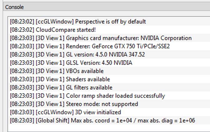

matknaak
Posts: 38
Joined: Wed May 04, 2016 12:43 pm
Re: 2.7 with windows 10 dosn't start
Post by matknaak »
here is (as you requested) what the Console reads when I launch CC directly from work:
As mentioned before, the same CC does not start when I try to launch it on the same computer but via remote conection.
cheers
mat
Can you run an older version via remote desktop to read the OpenGL version?
