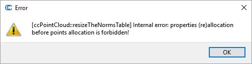

1) Busy time segmenting clouds
2) Better do a save.... highlight the top of the tree
3) Click Save
4) Then go back to segmenting
5) Ah No! the top level is still selected - CC invariably crashes with a segmentation error as it tries to segment every entity....
6) I smile, because I know I've just saved the file.
It would be great if after a Save everything is unselected so that segmentation isn't possible and the PICNIC doesn't occur !

Dooh ! I just did it again.....

Ah :) It wouldn't be too hard to deselect the entities indeed.
But I'm a bit concerned about the crash thing... It shouldn't crash :D. Especially since the number of entities shouldn't matter.
Re: Not so much as a bug....
For the records I just modified the code so as to deselect all entities on a (successful) save. It will be the default behavior for the next version.
