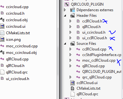

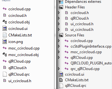

Here are files in my plugin.

I found it. I shouldn't have put the moc_.. and ui_.. files in my plugin.
