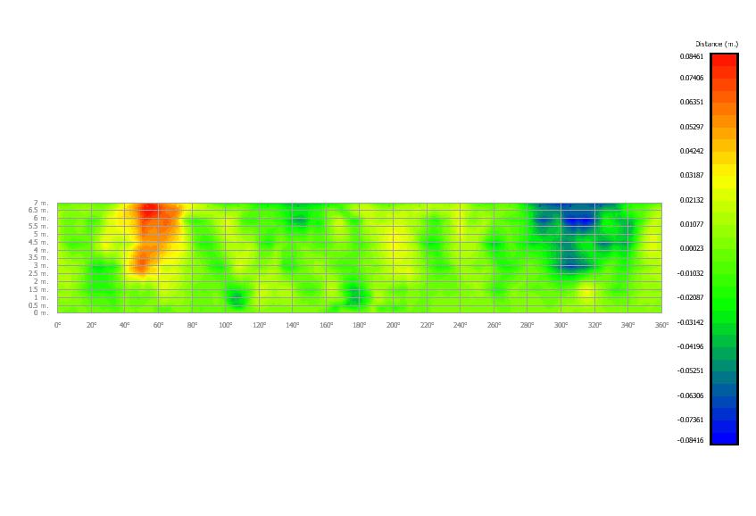

1- we work with the unroll projection to show the critical points obtained after run the surface analysis, the start point for the unroll is the opposite start point of the 2d deviation map, this make this image useless because change the interpretation of the images respect angles and height. For now I'm remaking this image with my own grid in a cad software using the unroll projection image.

- YOU CAN SEE THAT THE START POINT FOR THE UNROLL IS THE OPPOSITE.
- IMAGE 2D DISTANCE MAP.jpg (36.78 KiB) Viewed 12276 times

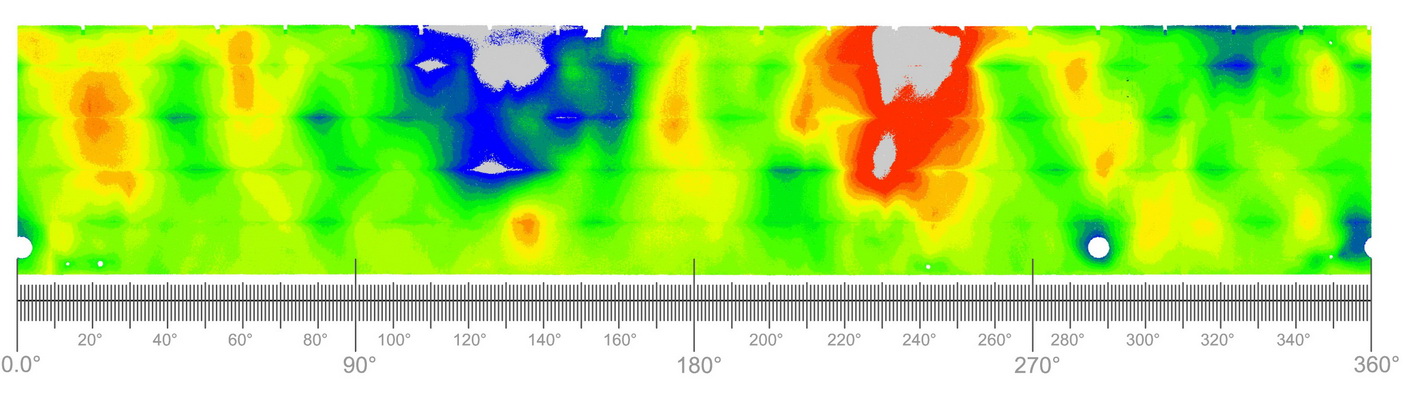

- REMAPPING THE ANGLES
- ANGLE REAMAP FROM UNROLL_resize.jpg (181.42 KiB) Viewed 12276 times

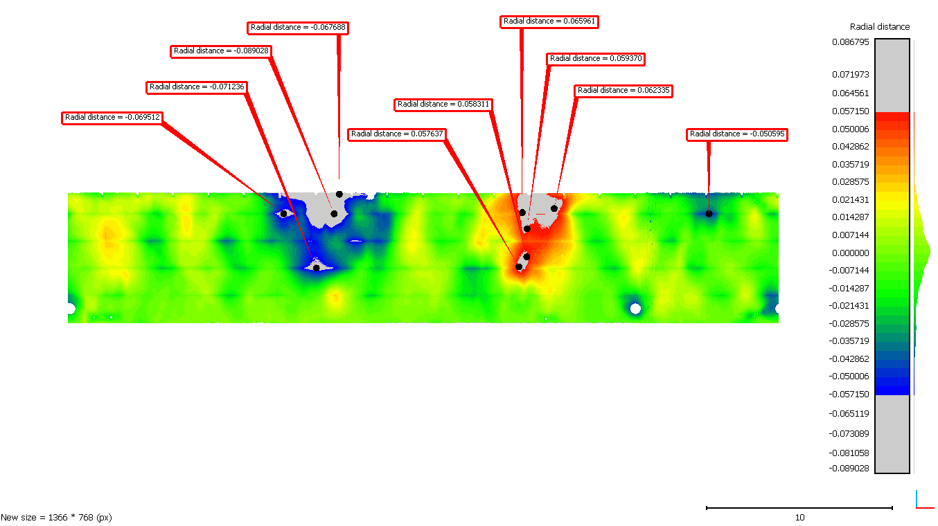

- CRITICAL POINTS FROM UNROLL PROJECTION
- CRITICAL POINTS.png (105.17 KiB) Viewed 12276 times

1. In fact the SRA plugin has a 'CCW' checkbox that allows you to choose in which side the shape should be 'unrolled'. Or did I misunderstood something?

3. The qSRA plugin has been developed by a private company (for their own usage). They didn't use the same angular 'zero' position as the 'Unroll' tool. However, I believe a simple rotation around the vertical axis (of a multiple of 90 degrees) should do the trick, isn't it?
