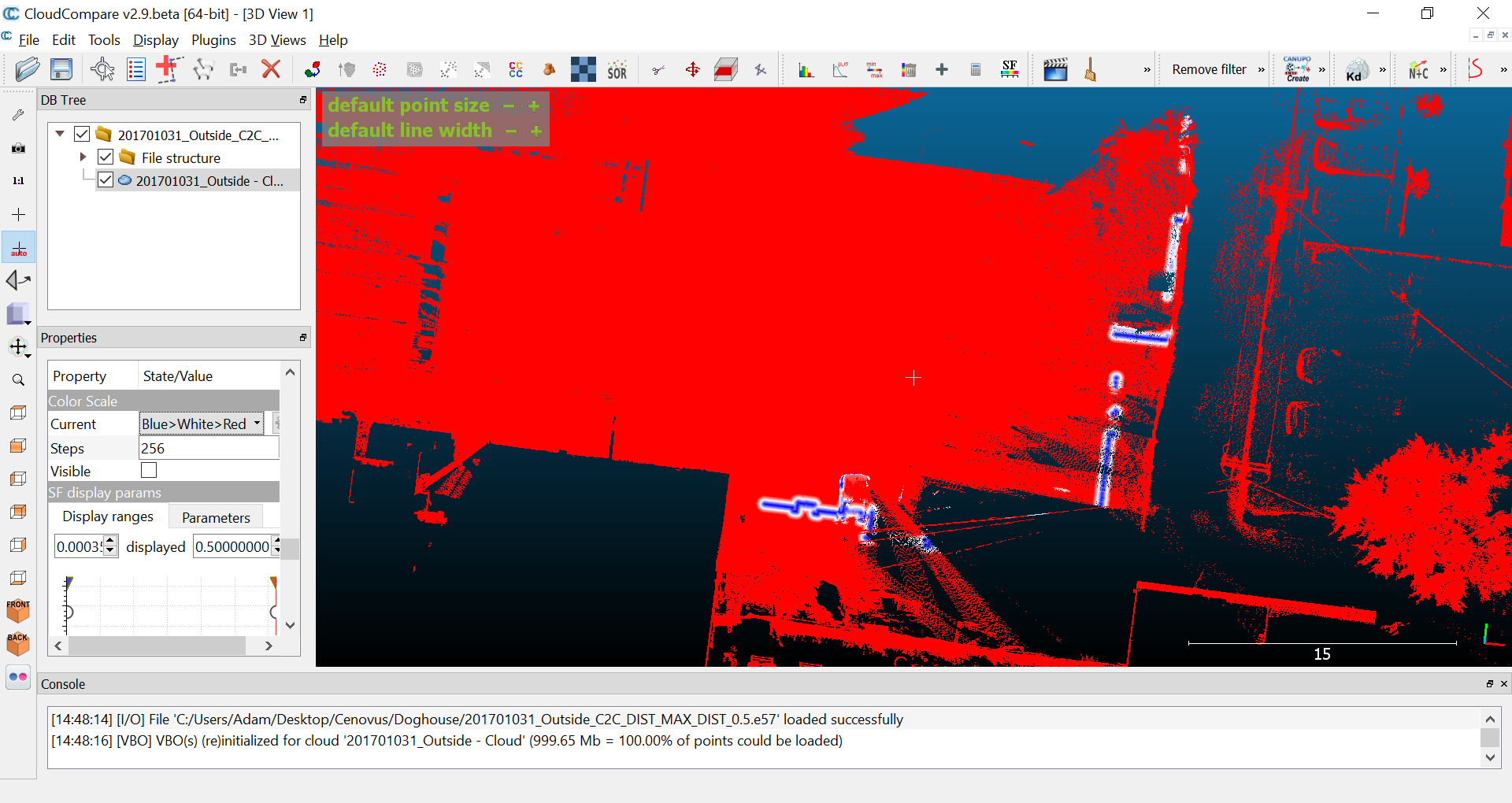

This process works fine when I use the GUI. However, when I replicate this in my command line, I get wildly different (and incorrect) results.
GUI (correct): https://www.dropbox.com/s/v4v53v1k4znn426/GUI.png?dl=0
Command Line (incorrect): https://www.dropbox.com/s/5ggvv4qre8azc ... e.png?dl=0

So, I did some more testing with the command line. I ran the same command line, but with "global_shift auto" after the open command. Both of these attempts produced the same results:
Two uses of global_shift auto: C:\Program Files\CloudCompare\CloudCompare.exe -silent -auto_save off -O -global_shift auto C:\...Cloud1.las -O -global_shift auto C:\...Cloud2.las -remove_all_sfs -c2c_dist -max_dist 0.5 -C_EXPORT_FMT E57 -no_timestamp -save_clouds
One use of global_shift auto: C:\Program Files\CloudCompare\CloudCompare.exe -silent -auto_save off -O -global_shift auto C:\...Cloud1.las -O C:\...Cloud2.las -remove_all_sfs -c2c_dist -max_dist 0.5 -C_EXPORT_FMT E57 -no_timestamp -save_clouds
Output: https://www.dropbox.com/s/ncb2c4trm5w3i ... c.png?dl=0
This is the output using the GUI, for reference: https://www.dropbox.com/s/k5w5ecm22f16l ... c.png?dl=0
I think I'm missing something, are you able to point it out?

In the command line output, the cloud-to-cloud distance has been computed improperly. The global_shift command fixed my original error, but introduced a new one. When the Color Scale is changed to Blue>Green>Yellow>Red, the ground in the scan and other surfaces that did not move show Green == ~0.5, i.e. there is a 50cm difference between Reference and Compared. I cannot replicate this output in the GUI.
