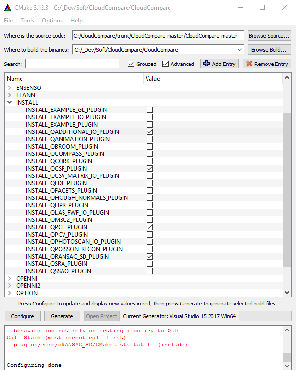

Hi to everyone, I post this because my CC compiled en Windows can't not load .pcd file.
I compiled CC eon Win 64, with CMake 3.12.3, PCL 1.8, Qt 5.9.4, MSVC 2017.
For the configure under "INSTALL", I checked QADDITIONAL_IO_PLUGIN, QCSF_PLUGIN, QPCL_PLUGIN and QRANSAC_SD_PLUGIN, the configuration gives no error, as illustrated below on left:
[img]C:\Users\SHAO\Desktop\CC CMake.PNG[/img]
Under Visual Studio, I have QPCL_IO_PUGIN,
But finally, neither in debug nor in release, I can't load a pcd file, with message as "[Load] Can't guess file format: unhandled file extension 'pcd'".
I would like anyone can help me to fix this problem.

I believe the errors in CMake are only warning and should be ignored (CMake wouldn't create the project files if there were real errors).
