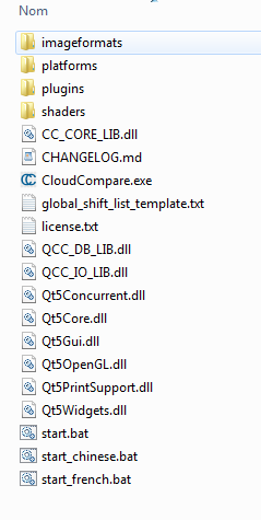

I've developped a simple plugin in CC 2.9.1 et I want to build a release version.
From my visual studio 2013, I've successfully build a release X64 version and I've got a new folder "CloudCompare" in my project folder where there are 4 folders ( ccViewer, ccViewer_debug, CloudCompare, CloudComare_debug). In "CloudCompare" folder, I've got the files as shown in image.
My question is: Does it complete? which files do I still need to copy to the folder to make the exe run in another computer (Windows without VS and QT)? ( I have no other computer for test by now. )

I foud it out.
Just to answer my question: need to add 2 VS dll (msvcp120.dll and msvcr120.dll) and it's OK.
See infomation: https://msdn.microsoft.com/fr-fr/library/8kche8ah.aspx
