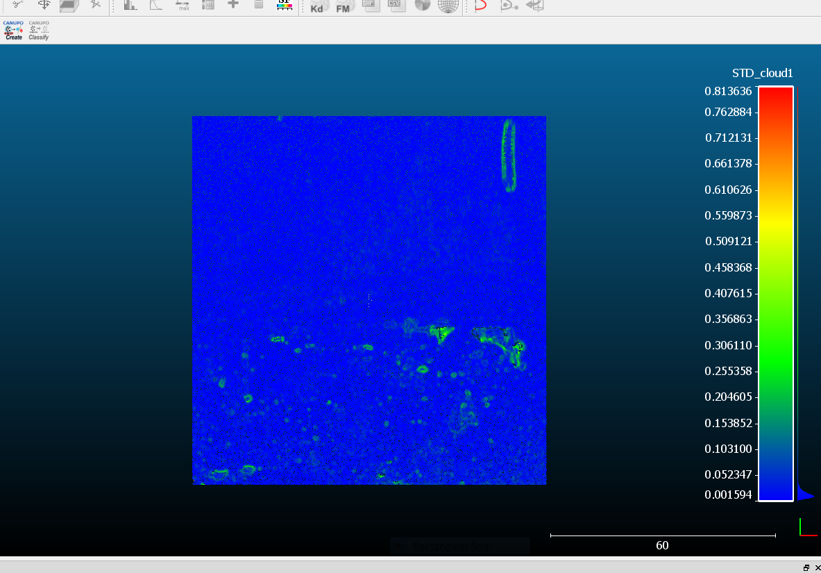

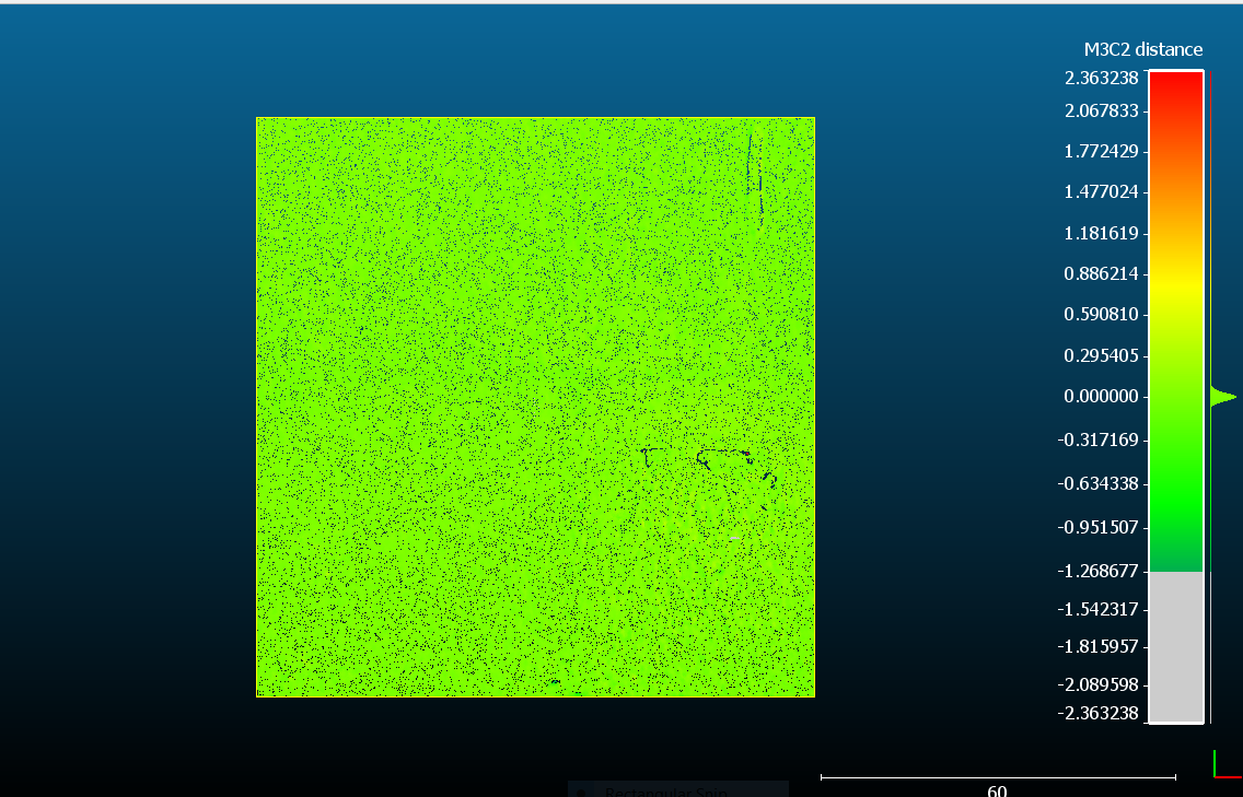

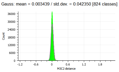

I'm having difficulties to measure the distance between 2 point clouds. Here I have used vertical distance. I want to be able to tell this is the vertical distance (height difference ) between them. Can you please look at the attached images and help me to figure out what is the average distance (my units are in mm). I'm expecting small-scale topographic changes. I have attached the histogram too but I don't understand the mean value and std (what they represent)?
I really need your help with this as I have no one to help me!
Many thanks

- cc Capture.PNG (273.3 KiB) Viewed 6670 times
- cc Capture2.PNG (198.13 KiB) Viewed 6670 times
- M3C2 Histogram.png (11.41 KiB) Viewed 6670 times

I never understand what you want... The average = mean = sum of all values divided by the number of values?!
And I believe I already told you that the average is not interesting alone (you have to consider the standard deviation in addition at least).
