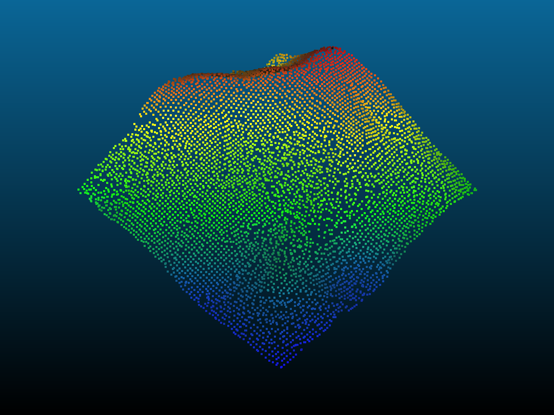

1) Did a merge on tiles available, removed xyz identical points (mainly from border) and filtered SOR (10 points and nSigma of 3). Results on a aprox. 3,300,000 points.
2) Rasterize tool on a grid of 5x5m to get the lower points, near the center of the grid (smaller grids returned too much points from vegetation) with all statistics. So this was my hard approach to get ground points.

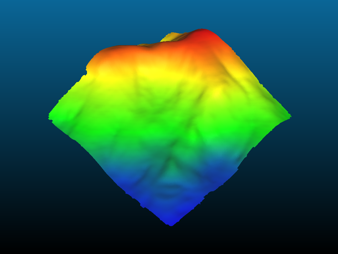

3) This point cloud turned to be my reference cloud and I've also generated a mesh from PoissonRecon plugin (octree depth: 10, point weight: 0, samples per node: 1, border: Neumman) and filtered it by the density scalar field to approximate it to the reference point cloud.

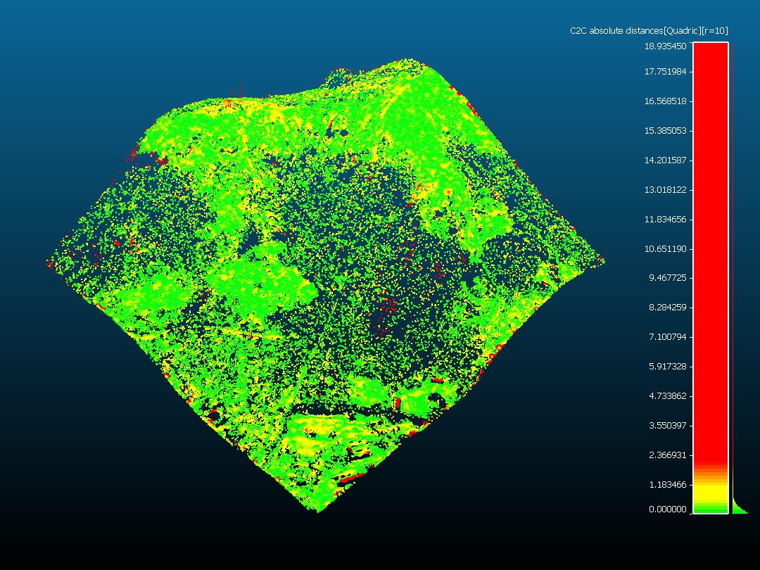

-- C2C by local model (quadric, radius of 10): returned the distances, but no signed distances. Got a glimpse of the distances and this might be a good orietation for the other ways of calculation distances. 18.93m was the greates distance.

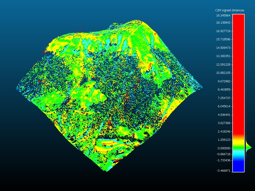

-- C2M got the signed distances and great visualization. This I can understand better as the points get lower from the surface or above it. I managed to create a color legend that shows in green the variation of 0.5m around the surface (0m) and gets another color by 1.0m and extreme colors by 2.0m I'm interested in the most points around +/- 0.5m of the reference (cloud or surface). 19.34 was the greatest positive (above ground) distance calculated. An increase of 2.17% for the same cloud. <br/>
5)Now I'm on to M3C2. My initial setup is:
Cloud #1: reference ground cloud (around 5m spacing)
Cloud #2: new ground classification to test
Scales: guess params results: normals of 25, projection of 25, max depth of 30. I guess these are due the approximate 5m spacing of the reference cloud. Check on compute normal on core points. I've setted as D= 26, d= 12 and depth of 50.
Core points: Use Cloud #1.
Normals: Multi-scale min=6, step=2, max =100, check on use core points for normal calculation. Should I check on Vertical for using ALS data?
Orientation: Z as I'm working on ALS data (?).
Advanced: Check on "Do not use multiple pass for depth"
Output: Project core points on Cloud #2. Check on export std devs and density at projection scale.

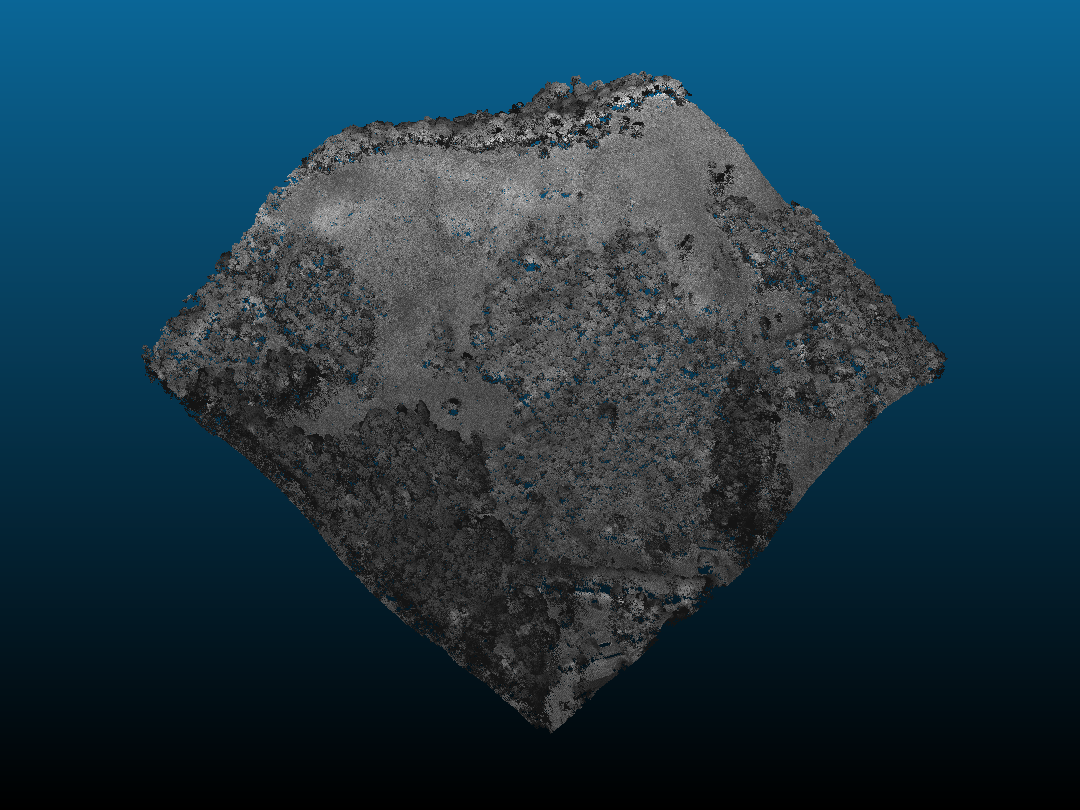

Reference cloud obtained by rasterize tool
C2C distances
C2C distances
C2M distances
C2M distances
Reference surface by PoissonRecon
