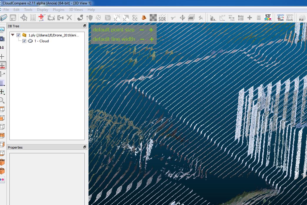

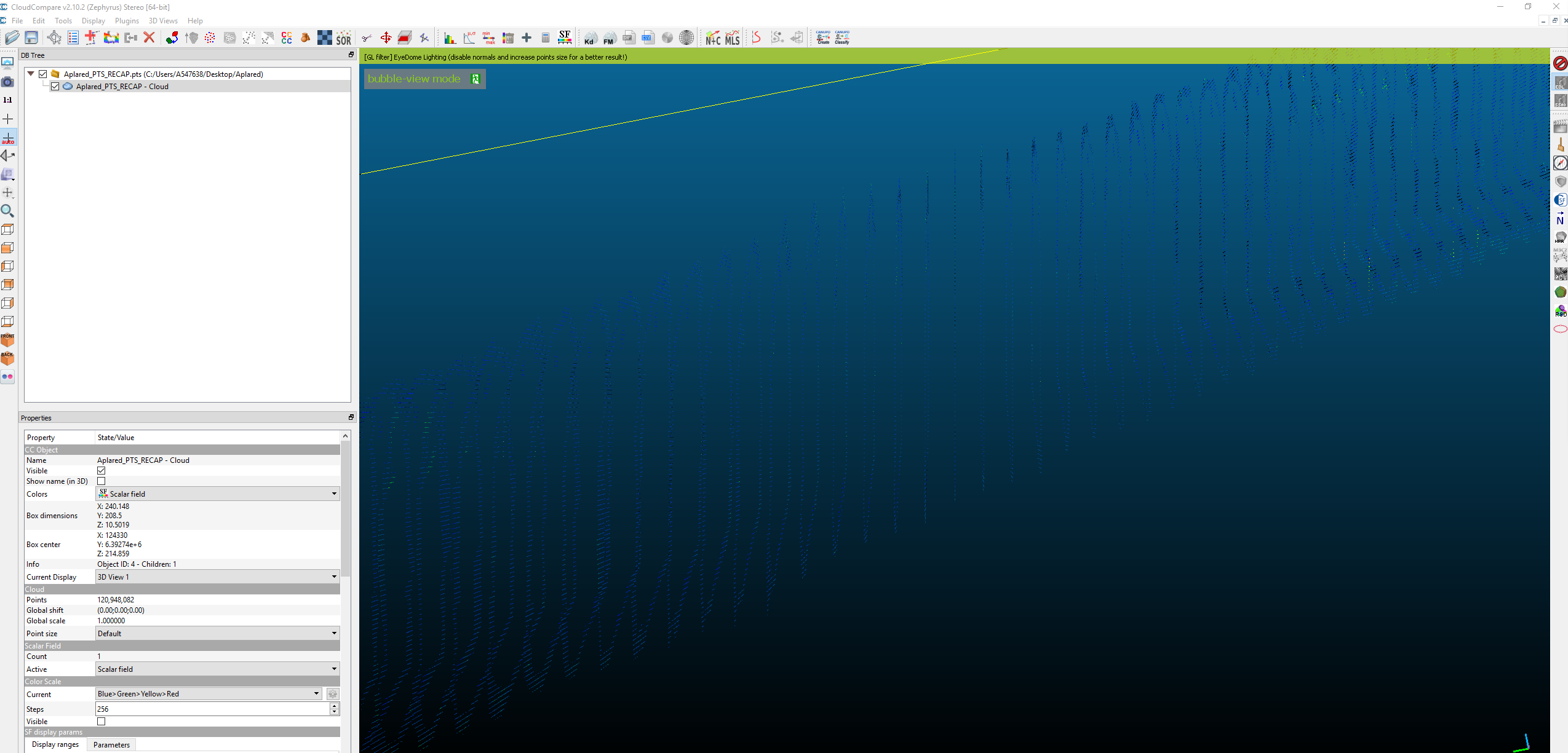

Hi, i have a very special issue that i havent seen before. In CC my pointcloud slices up and looks really weird, i have tried the same pointcloud inside of leica infinity and also i recap and it looks good with no problems at all. so im hoping that someone here has a good idea :)
PC1 shows how it looks in CC
PC2 shows how it looks in Leica Infinity

This typically look like an 'accuracy' issue. Have you accepted (and read carefully the warning message) the Global Shift as suggested by CloudCompare when you load the file? ;)

I'he the same problem ....Help, please
Re: Point Cloud becomes Slices!
Same question: have you accepted the Global Shift as suggested by CloudCompare?!
