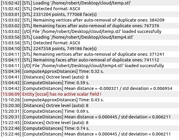

This is a great tool, with really nice documentation as well! I'm using it to see differences in STL files, and within the GUI it works great, but when using this command
cloudcompare.CloudCompare -o temp.stl -o temp4.stl -c2m_dist
It fails with the error:
No point cloud available. Be sure to open or generate one first!
The images show the console output. Not sure if there are any additional command line steps I need to take in addition to loading in the files, but according to the documentation I seem to be doing it correctly?

Yes, the C2M command is meant to compare a Cloud (C) with a mesh (M). In the GUI version, the tool automatically uses the vertices of the compared mesh to do the calculation. But not in the CLI version.
You have to chose between two options:
- use the same strategy (compute the distances on the compared mesh vertices only) with the -EXTRACT_VERTICES option after you have loaded the compared mesh (it should be loaded first)
- sample points on the compared mesh (it's better if the compared vertices density is low) with the -SS tool (and don't forget to remove the loaded mesh afterwards)

Thanks for the reply. The problem is that I actually want the mesh as output, rather than the cloud (the inputs are both STL geometry, and I want the output to be an STL geometry as well, so that I can view the physical differences) But, I downloaded the nightly branch from snap and now it's working. Seems the command line tool now copies the behavior of the GUI - cool!
The filter points by value tool I notice is working both on clouds and mesh, in the GUI. This is useful, because around 90% of the STLs are identical, so I typically filter away differences less than 1mm and look only at significant differences. But, the command line filter_sf option only works for clouds.
Would it be possible for the command line tool (filter_sf) to automatically operate on meshes, like in the GUI? At the moment, the only work around is to convert the mesh to cloud, as you suggested, but this then results in a point cloud which isn't useful for visualizing the surface. So, I currently do the "filter_sf" in paraview.
